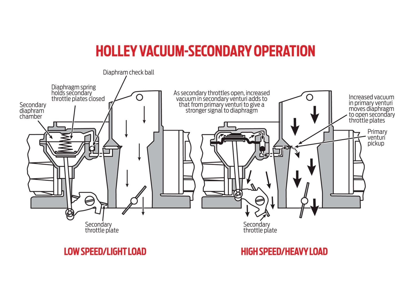

That's a pretty common problem with today's holley vacuum secondaries... It seems some of them just don't work that well, even with a lighter spring in the pod. I had brand new 3310 that the secondaries would only open about 1/2 on a 6500 rpm 396. It seems the port in the venturi that goes to the check ball in the vac sec circuit is just not big enough. I ended up having a 65' Holley 780 vac sec rebuilt, it has a little nozzle on the vac port in the venturi and the secondaries fully open on it.
Your combo will easily handle a 750 double pumper (4779) and that's what I would put on it. Then you KNOW the secondaries open, and it will hit much harder...
Mechanical secondaries are really the way to go on a good/moderate street motor...

This is the vacuum port for the vacuum secondaries, this seems to be the problem on the newer Holleys. Either its not drilled all the way through, or its not sized correctly. On the new carbs, its just a hole, no nozzle like this one in the pic.

Put a paper clip on the rod that connects the diaphragm to the butterflies right at the base of the diaphragm can, then drive the car and hammer it. The clip will slide down the rod and stay at it's max opening point, and you can then see how much the butterflies moved when you're done. Super easy to do.

Ok you won't feel the secondaries kick in as they open as required.
Now if the diaphragm for the secondary's is leaking they won't work at all.
This is my before and after repair. Also note they open as required.
