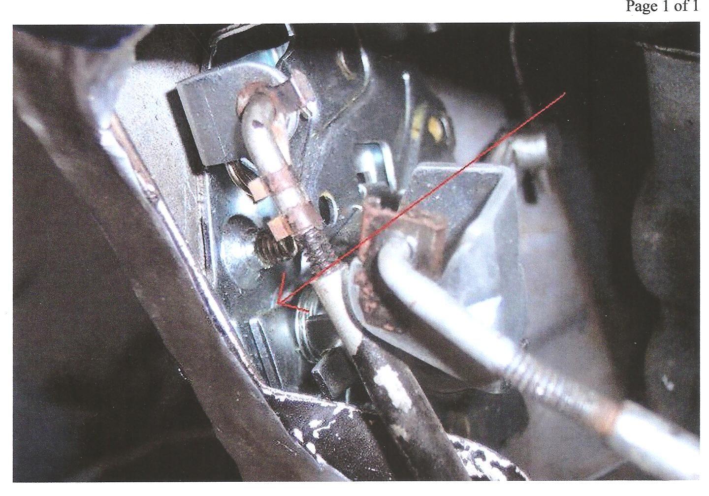

Push down on this part:

If neither inside or exterior handle work, take off the door panel and put a screw driver on the part in the pic. and press. You dont need to remove the vapor barrier. You might could reach it without taking off the panel since it is right at the notch at the latch opening inside the door.
I'll give that a shot and see if I can get the door to finally open.

No need to take the door panel off.
Just roll the window down and with a flashlight and a long screwdriver locate the 'part' and push down on it.

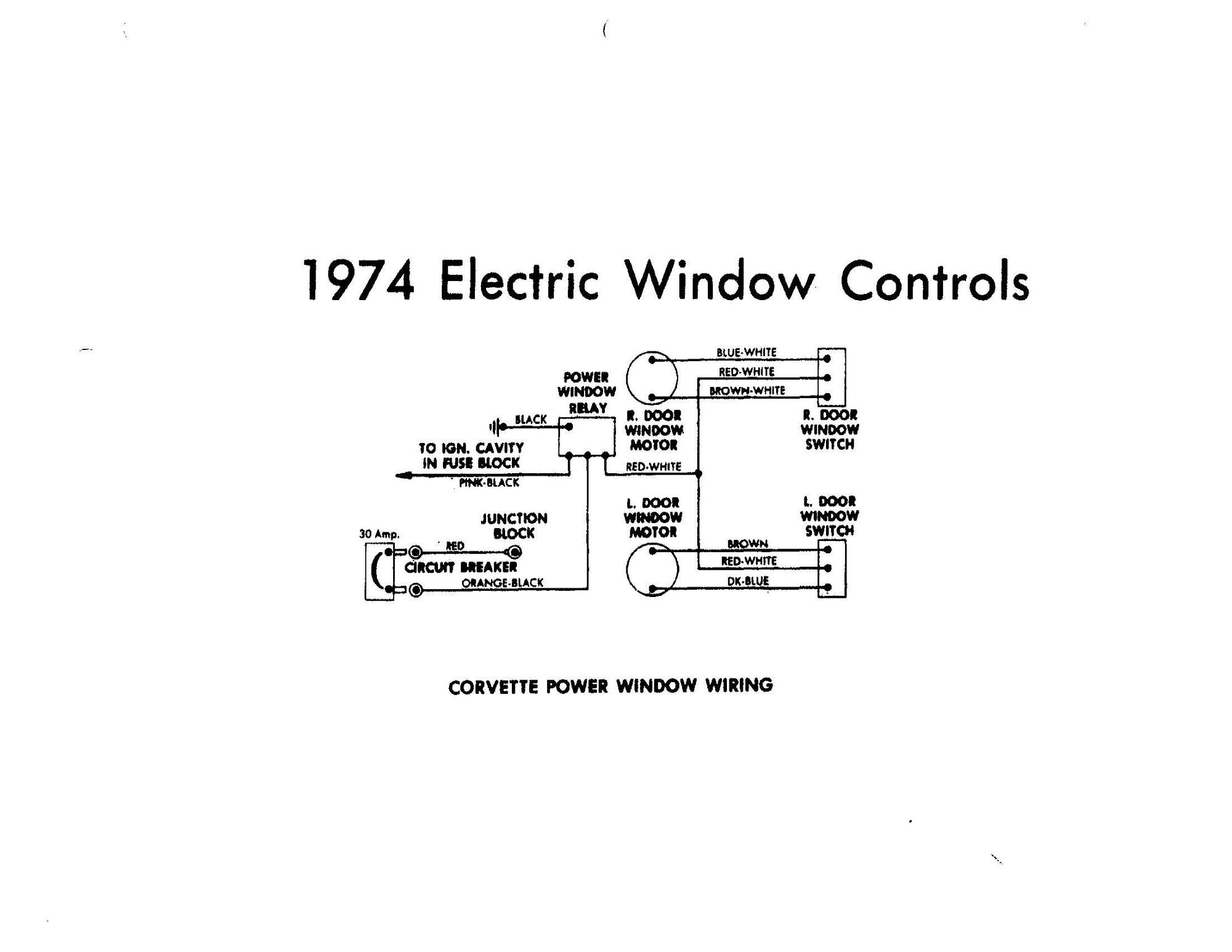

Would the combination of door panel off and window up work as well? My power window decided it wanted to stop working at the same time.

Hi Again,
#1 Is the door panel off or on?
#2 Let's see if we can get the window down first.
At the fuse box see if the PINK-Black wire is plugged into the IGN cavity.
Then with the key ON see if the window works.
Old Feb 20, 2018 | 07:19 PM
73TexasVette's Avatar
73TexasVette
Joined: Sep 2016
Posts: 32
From: Georgetown Texas
Originally Posted by Peterbuilt
Hi Again,
1. I've got the door panel off
2. I see the wire plugged in and the driver side window operates so according to the diagram my relay is getting power. I also tried swapping the power window switches to see if that was burnt out but no luck.

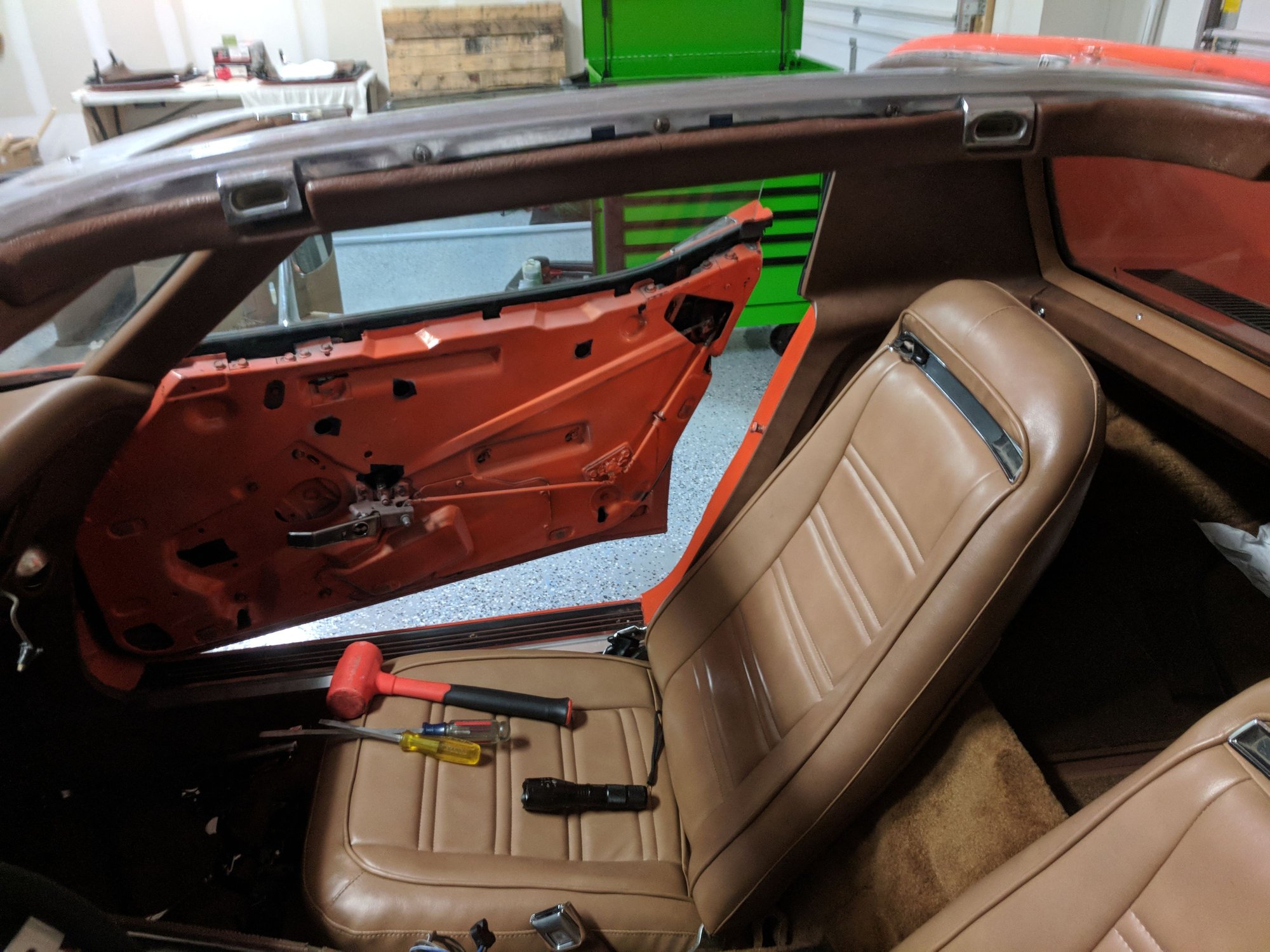

So I finally got it open While removing the panel for the power window motor I figured what the heck I'd try pressing on that lever one more time except this time I used a hammer and a little brute force
Thank you Peterbuilt for all your help! Now on to stripping the door mechanism and rebuilding it.
