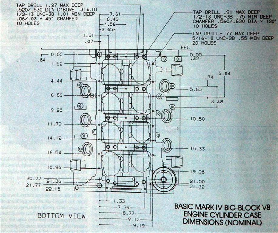

Just a tip, been down this road many times!!
Make absolutely certain the shop is VERY familiar with doing the 4-bolt conversion! If you get a less experienced machinist/shop it's real easy to literally ruin the block.
This has nothing to do with "fitting" the caps, it has to do with drilling the depth on the outer row of holes along the driver side of the casting.
Thanks, Gary in N.Y.
P.S. I would supply 1 OEM outer (short) bolt and tell them to drill the new holes only to the depth on the bolt threads, no deeper!

OK, I just pulled out a couple sets of main caps. the 2-bolt and 4-bolt Mk 4 caps measured within a thousandth of each other from the outside of the register shoulder to the surface the bearing sits in. the gen 5 caps are offset a couple thousandths to 1 side. Muz, you have 10 main caps. 1 assume the 2 bolt caps are numbered so you can tell which one was where? I also assume you have some decent quality mikes and know how to use them? sit down and measure them all and see if and how far off they mike up from the orig caps. those billet caps don't count. they weren't made by GM in the same house where that block was made and and trued up to another same gen block on that same line.

muzzy, that number is WAY high. I've done this job 4 times on my Bridgeport, my self. It's not really a big deal. Set the new caps on where you want em, use a centering punch to mark the hole you are going to drill and make sure you use the depth stop. I used the bridgeport to start the tap to keep the threads straight. There's a lot of play in the cap bolt holes so if you are within a couple thou of center it's o-k. They do need to be line honed when finished. I've used factory caps and I used billet Chinese caps. The Chinese caps needed line bored 1st, then line honed, both ways turned out nice.
👍 thanks for the info, I was also going to use the Bridgeport to start the taps but I was going to put some brass tubing in the chuck to hold pressure in the backside of the tap and hold it straight and hand tap.
