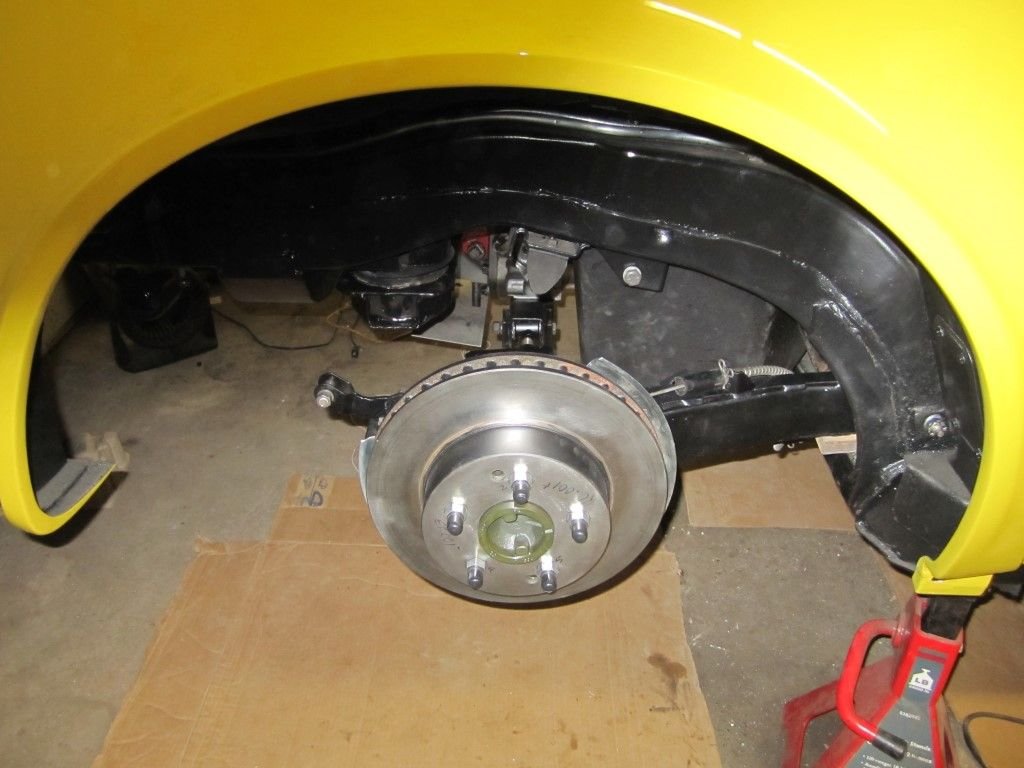

275's fit with ample room after this mod. I highly reccomend it to those with performance engine mods or ones looking for a better handling C3!
The info can be found here: (Im sure you've seen it)
http://www.corvettefaq.com/c3/MoreBite.pdf
Did this to a 74 Corvette with an LS1 / T56 Swap. It can Dig with the best of them. We went with a 275/60R/15 Tire but Im sure you could go 285 maybe even 290 with stock trailing arms with this 1 mod. It was very easy to do.
Heres a video demo on the 74 LS1.

Here is a golden opportunity for a vendor to make a bracket for moving the parking brake cable inward, without disconnecting the cable and can be either bolted on or tack welded for say: $15 a pair + shpg. (just cut the old one off and pitch it)
Would sell several I bet.
Old Feb 26, 2018 | 05:53 PM
Mooser's Avatar
Mooser
Joined: Apr 2011
Posts: 11,183
Likes: 3,335
Just use the replacement ones $13/pair usd)
Exactly what did. Just bought the brackets from CC and moved mine to the top didn't take the cable off or anything.
Did the same when I put the new arms on last time
M

Thats a great Idea! would save time carefully removing and prepping the original ones!
