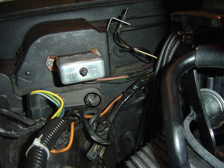

See post #13 here:
https://www.corvetteforum.com/forums...h-to-puke.html
Here's the nut that is in the engine compartment.
Instruction #8 from Corvette ED's
Also, Paul L did it on his '74 w A/C PM him for some detailed pictures.
