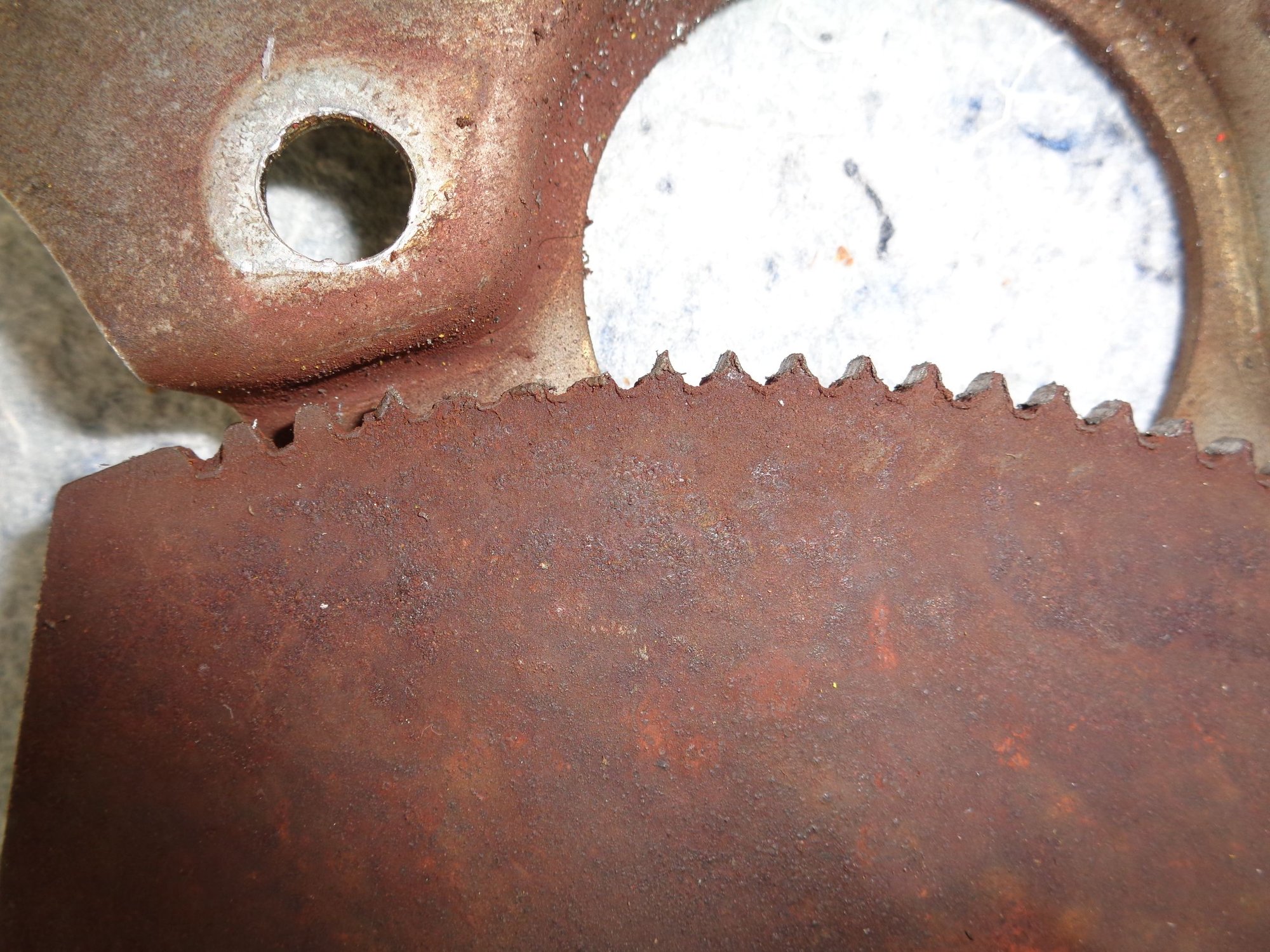

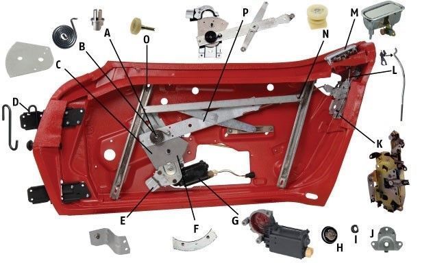

Ok, here's what's inside:
Here's a close up of a worn gear:
Fantastic,Thank you.

worn gear, replace it, clean & lube all window componets on both sides.

When you take it apart make sure to check both the drive and driven gears... when the regulator gear teeth are gone it's almost certain the motor drive gear is gone as well.
I'd also advise you to just purchase the regulator, you can purchase a tooth repair kit but they are kind of cheesy. Stay away from the imported regulators, the rollers are not the correct size and can cause you even more headaches.
