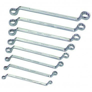

I use an offset box end wrench to remove the spark plugs that are hidden by the header primary tubes.
