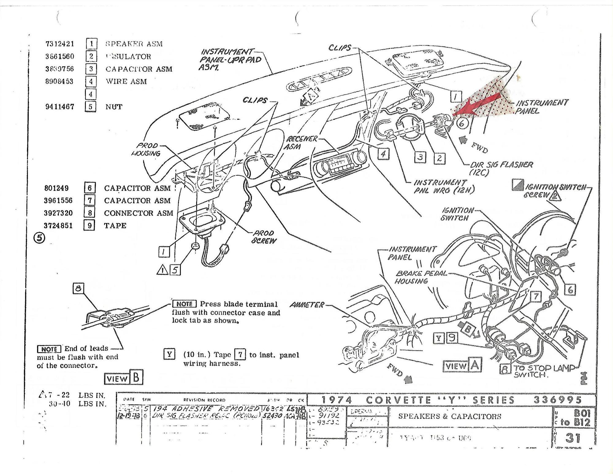

Your turn signal flasher is under the right side dash.
Here's a picture.
While you're at the parts store pick up a Haynes manual for your new (to you) Corvette.

Thanks for the diagram, I ordered a flasher kit. Yes I have A/C

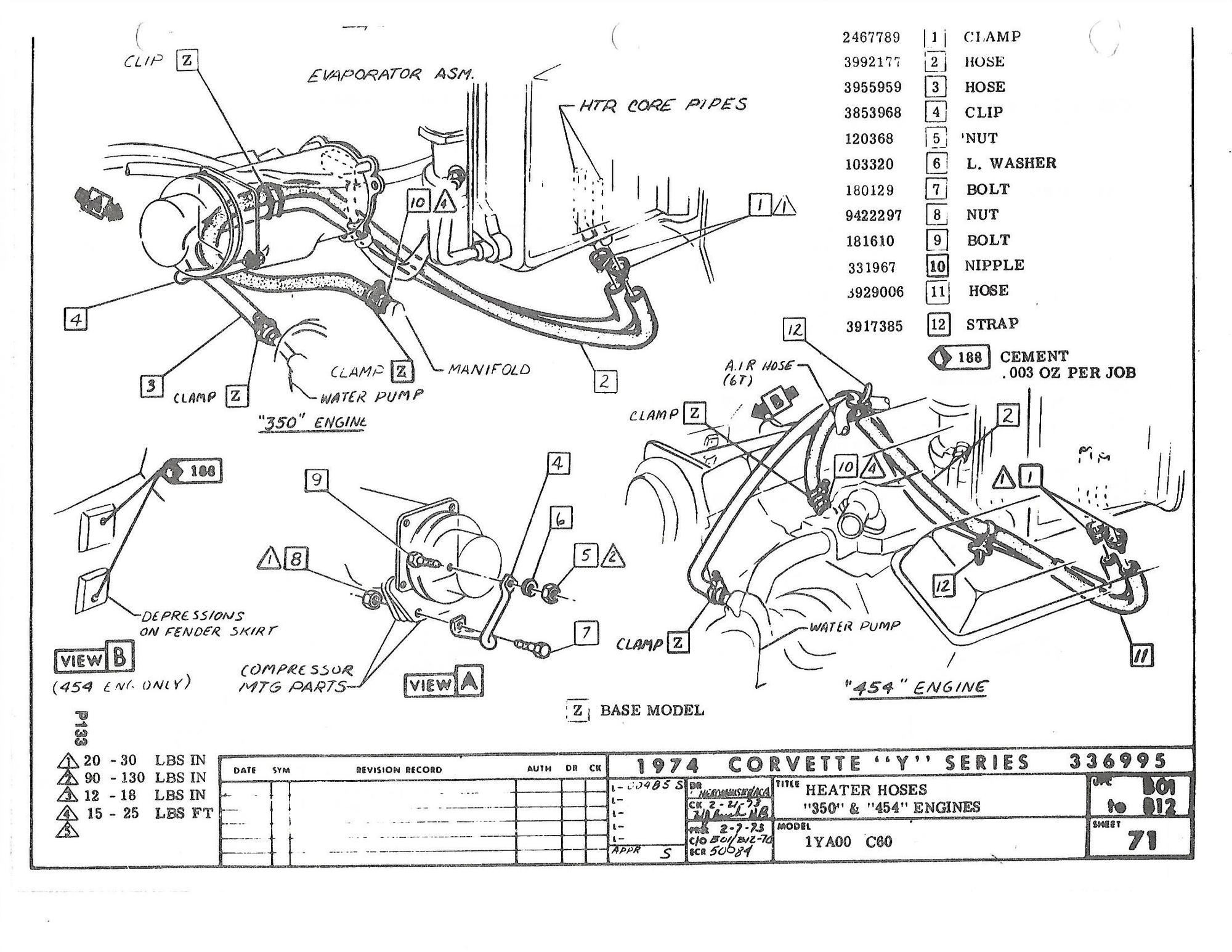

Default About water leaks.
Originally Posted by Sundance_Actual
Yes I have A/C
With A/C, you need special molded heater hoses.
Cut the old hoses off with a razor, don't try to pull them off because you can break the heater core.

Here's a picture of the hoses:
https://www.paragoncorvette.com/sear...archTerm=6502k

Originally Posted by Peterbuilt
Thanks again, If i remember it would be the Number 3, I know the hose was on the underside. Il climb under again tonight and take a better look at it
