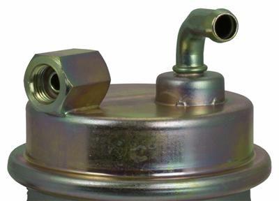

Jim I ran into a snag with mine. I bought the aluminum fuel line cause I thought it might be easier to bend and reduce heat. However I cant get a tight 90 degree close bend in it to attach the straight 5/8-18 inverted flare to 6 an straight fitting to it. I thought it would be a simple 90 adapter to fix but so far I havent found one. you said you had one but maybe your pump is different. Mine looks like:
So I needed a 5/8 inverted flare to 6 an elbow - so far no luck was your pump different? So far I only found a 5/8-18 inv/flare to 3/8 npt then use a 3/8 npt to 6an elbow. Or maybe use steel line that could bend tighter or different fuel pump......driving me a little nuts on which way to go.
I did just think I can use the straight fitting then get a -6an elbow and attach to that. Unless you have another thought Ill roll with that.
I found this pic of yours on another thread, do you know if this was a inverted flare elbow or just a 3/8?

That was a 3/8 NPT x -6 AN elbow and it worked fine as long as you are using AN hose.
