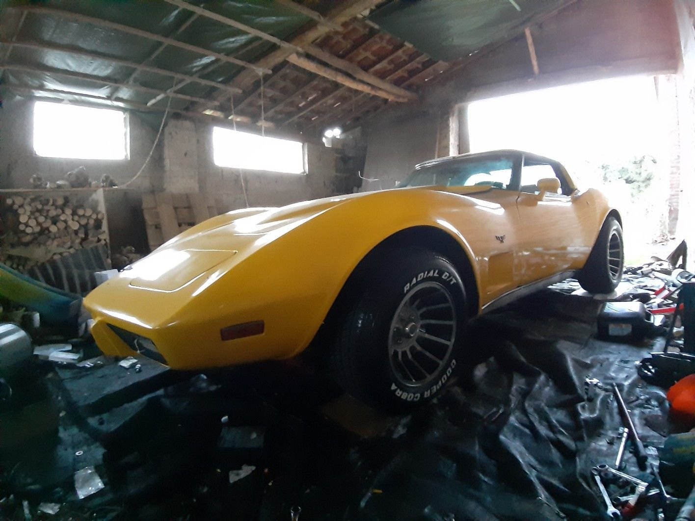

Im here again! After painting the car and it sitting for a few months now, it gets harder to close the doors again.
Could it just need some more shims after the body mounts settled? Cant imagine the door hinges wore out by just sitting ( new pins etc in there too)
I can adjust the catch lower, but the door doesn't line up properly with the rear fenders then.

It's been sitting between September and January on jack stands, but has been off them since ( problem did start after the jackstands)
Only solution I can think about( if it doesn't settle)is to enlarge the door hinge mounting holes so there s more adjustment over there. Not something I d really like doing as taking a pa
inted door off will probably result in tears. Dont even know If you can reach the bolts with the dash etc in place.
This is how it all looks
