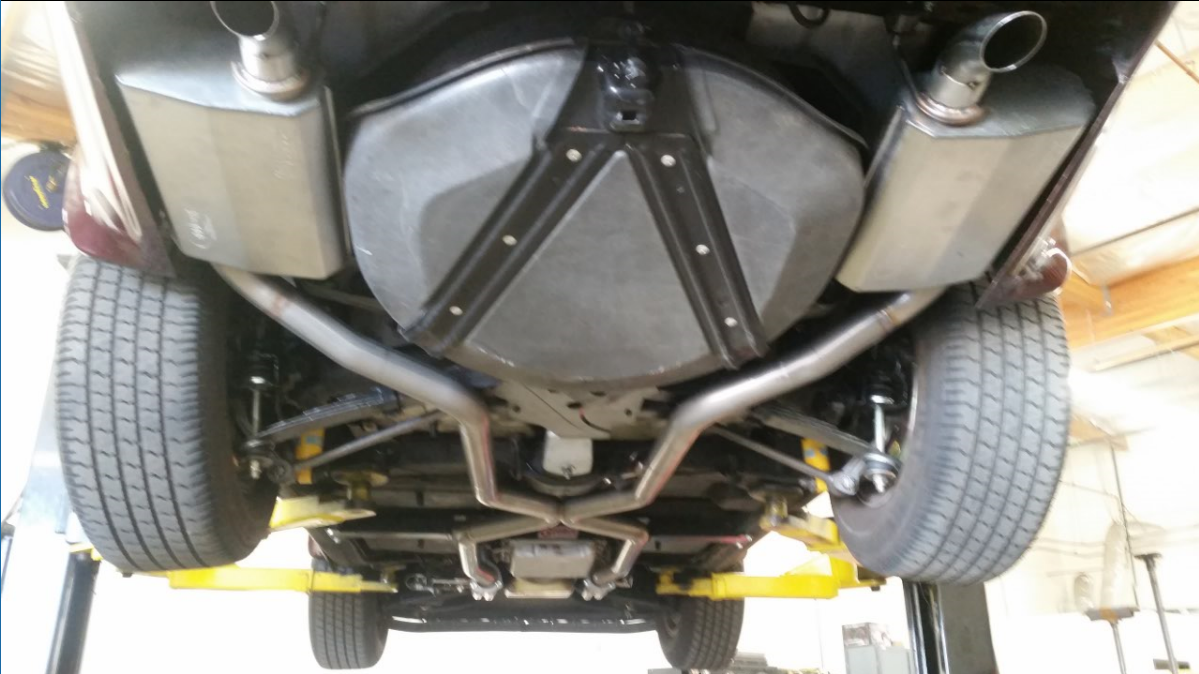

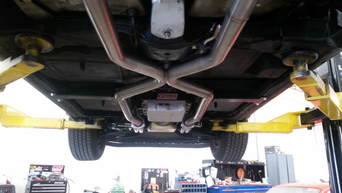

Here are a couple pics of my exhaust on my 82. Good luck with your choices.

Thank you. If you want to run the smog pump, those Hedman headers have the fittings for the one-way valves ang A.I.R. tubes. Mine does not have those anymore and my pump is now removed. I run a 383 vs. the stock 350 and have a lot of changes, but the exhaust between our cars could be the same if you want it that way. The ECM should be OK with the change, make sure you use the O2 bung for your narrow band O2. You relly need to know what your fuel pressure is on a CF motor. Once you put headers on it, ensure you run 13PSI measured in-between the TBs and the motor will run just fine. BTW, enjoy the increase in power.
If you don't use the cross-member that I used, it will make it more difficult to install the pipes. Since the new cross-member is a pass through bottom setup, it is really easy.

3) My X-pipe I made myself as I was fabbing up the tubes, easy to do if you have the tools and a TIG. Any X-pipe will do really as long as the angles are correct for your application. Maybe the shop that is doing yours can fab you up one as well. Just cut out the center of the bends where they meet.

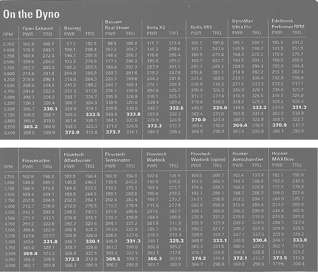

Here is a good article to read on exhaust systems: http://www.superchevy.com/how-to/exhaust/0505phr-exh/

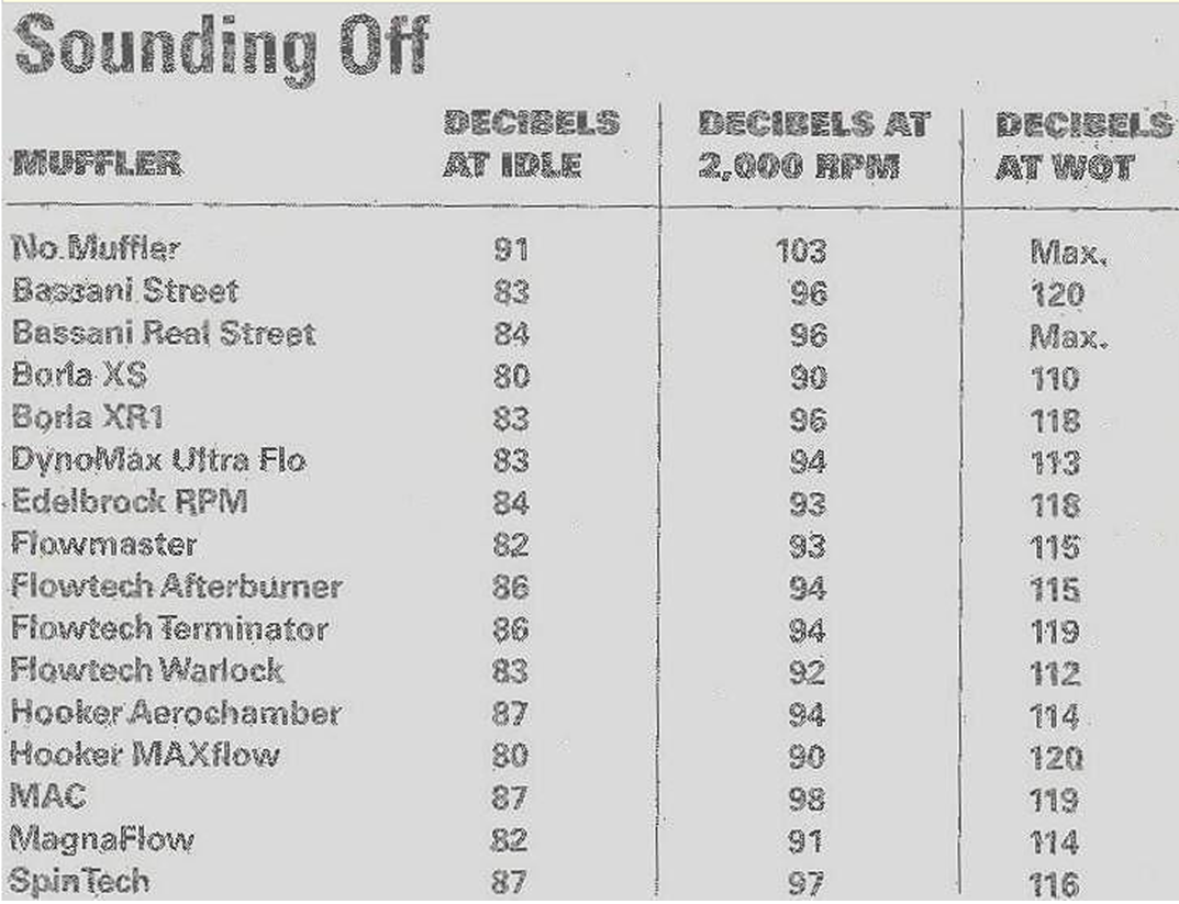

Here is some info on mufflers as well:
As a side note...The 82 vette two tone Silver Blue/Dark Blue like yours and garrettb has came in two interior colors only. DB=Dark Blue and SGY= Silver Gray
Hope this helps.
