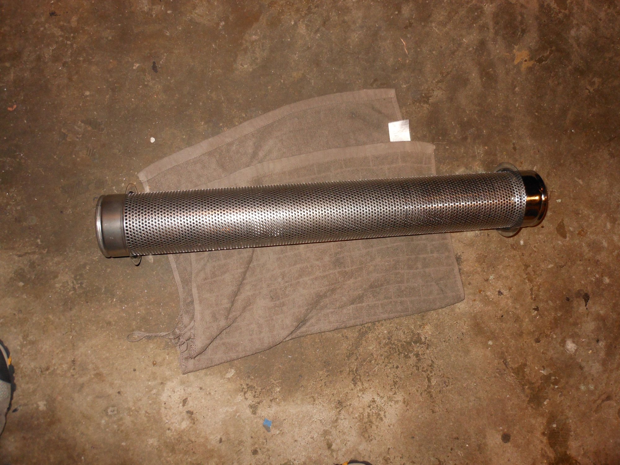

I can only talk about Magnaflow glass packs. I tried 18" and 22" 2.25" cores to make my hooker side pipe inserts. I liked the 22" better. The good thing about glass packs is they are cheap and whichever one you choose you can change your mind pretty easily.

When I made my sidepipe's "glasspac" type mufflers- I found where after 20" or so of muffler length- making them longer didn't made a difference as far as sound.

I have similar mufflers to cherry bombs mounted on my 71!
I couldn't find a better picture than this unfortunately.
But the car sound really nice. Throaty, no resonance and really nice sound. Not too loud but more than with stock mufflers.
