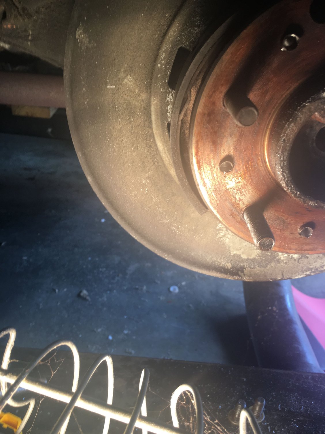

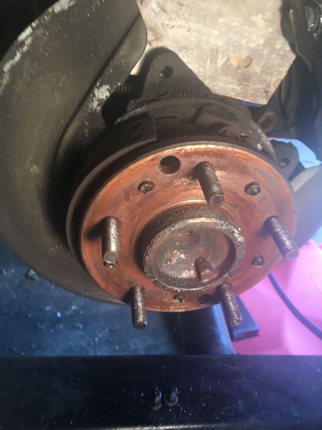

Old May 2, 2018 | 03:52 PM
croaker's Avatar
croaker
Posts: 2,369
Likes: 103
From: Centerville Louisiana
This is what I'm seeing. I had to make three crank to get it lose. I expected to see something more obvious.

Old May 2, 2018 | 06:34 PM
GTR1999's Avatar
GTR1999
Joined: Aug 1999
Posts: 15,175
Likes: 3,990
From: Connecticut, USA
The parking shoe is out past the flange, the springs are most likely broken.
