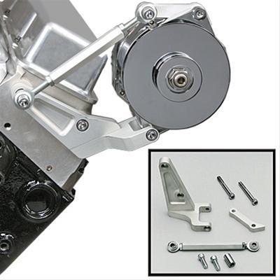

Billet unit from Summit. I had to extend the adjustment arm as I have wider fabricated valve covers, so not really compatible with tall or wide covers... but with stock covers will work nicely out of the box. I went out and bought some longer socket head hardware before installing as I had to shim mine for other reasons, but they do come with hardware. For small block... and they offer one for BB.
Got the part number for that bracket. I don't like my header bracket as the bolts keep loosening up over time and it's a bitch to tighten them as the only bolts I could get in there were socket heads.

I'm having a hard time finding this bracket kit's part number on SR.com
Can you post it up please.
EDIT - Found it - Billet Aluminum Alternator Brackets SME-2001
