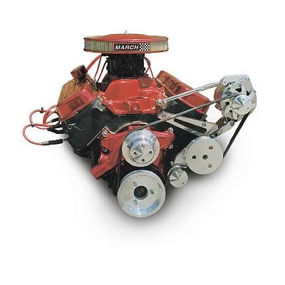

My setup is a 496 BBC in my '75 using March Performance 20560 serpentine belt setup. Look like this with a smaller crank pulley for high water flow. Edelbrock 8852 water pump and type 2 PS pump.
