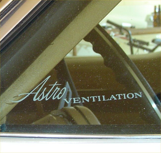

Should say "Astro Ventilation" on the side windows if original. (Even if you don't have the system)

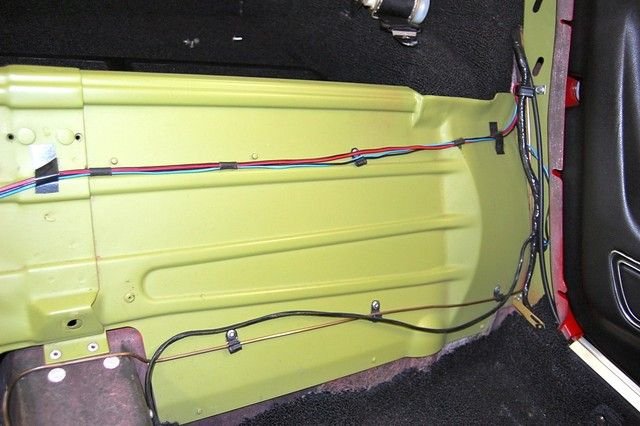

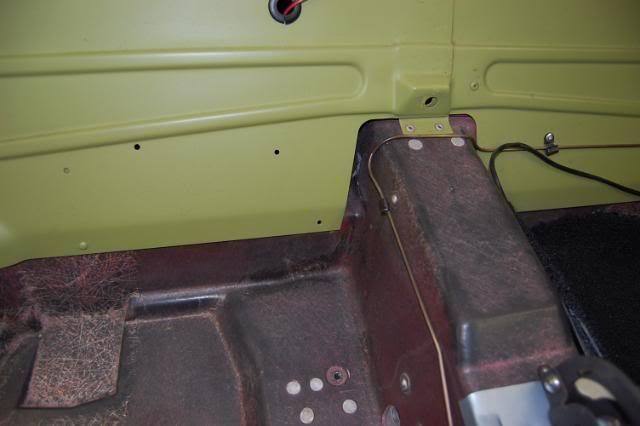

I'm wondering about when you say tubes? Is there more than one?
For the Non-A/C there should be one metal tube, goes along the driveshaft hump on the passenger side, up over the hump where it runs into the rear divider behind the seats and continues across to the drivers side and then up the b-pillar as a rubber hose.
A/C cars didn't have that rear vent part as far as I know and the verts were on the passenger side?

These are from Alan. I just did mine last week.
