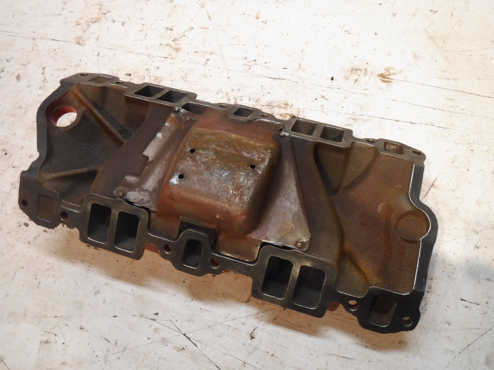

If your intake has a heat shield on the underside, it is critical that there is no blasting "media" remaining under the shield when you reinstall it on the engine.
These shields trap a lot of oil sludge in them over the years and if media gets trapped in there when it was blasted, some of it will find it's way into your oiling system and very likely wreck havoc on your engine. The factory shields are retained by expanding rivets and can typically be pried off and later replaced with new rivets. If there is no shield, or it was removed before blasting, you should be good to go.
Good luck... GUSTO

Every manifold does not have a heat shield. Many aftermarket manifolds do not have them. I can't recall many factory manifolds that don't have them however. Does your's have the holes in it where the shield retaining rivets go in?
Finding a shield would normaly require taking one from another identical manifold. I've not seen them available separately, although the rivets are. It is probably not critical and is intended to keep internal heat off the bottom of the phlenum. If you can't find one and are concerned, I would just block the exhaust heat crossover ports to compensate. The block off plates are often included with intake manifold gasket sets.
You may want to post a picture of the underside of the manifold and the folks here can offer additional guidance. I would also post the manifold casting number as someone may have what you need on an old manifold.
