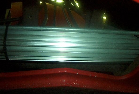

This is for my 4l70 but location is a location. Excuse the wiring mess.
Does that hang down past the radiator?
Nope, the cooler lines tuck up and are secured on the top side of the radiator core support. The cooler is thicker/deeper than others, but obviously not at wide. I was limited to width because of the electric headlight motors so I went deeper.
Might have to compare manufacturer ratings. Another option would be aux. fan setup for when sitting in traffic.
