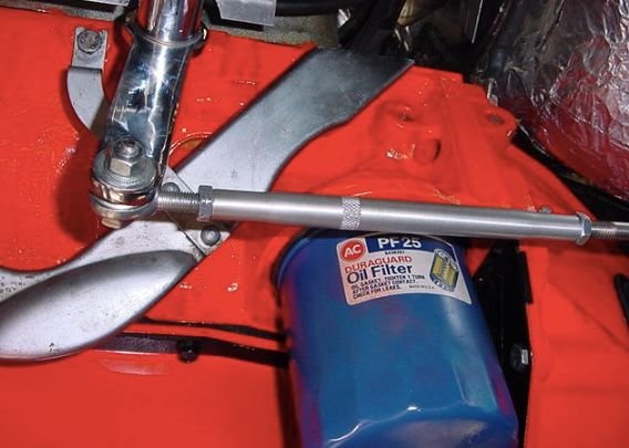

Well OK I guess. Changing the subject slightly I switched to heim-jointed linkage. This stuff:
