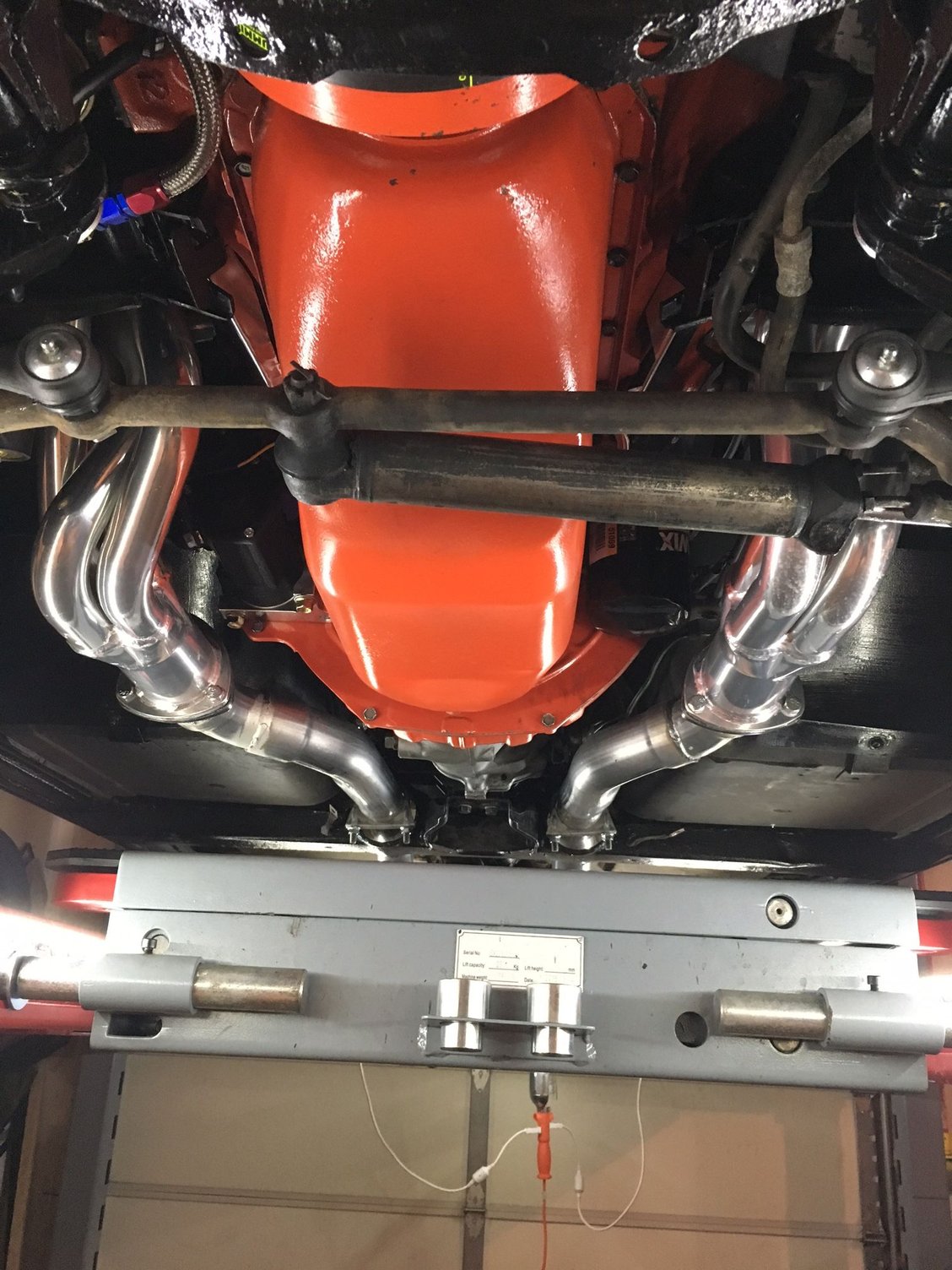

I have a 68 wirh a 327/350hp so pretty much the same as yours. I installed Hook Competition Headers. The bolted on with no issues. You will have to modify your exhaust pipes with any headers. What I did was bought the headers painted and had them ceramic coated iside and out. Factory headers are not offered coated inside unless you buy custom headers. My header were just over $200.00 and the coating was $200.00. Can't beat it for $400.00.

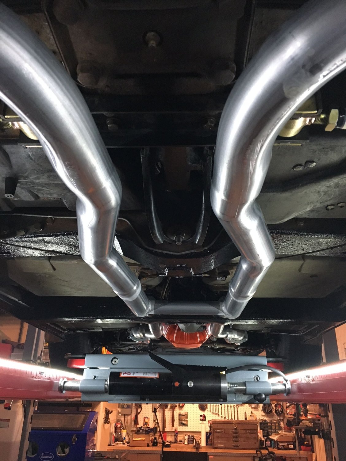

I am running Doug's Headers D350 on my 1970 w/355. They fit perfectly with no mods or denting. They are long tube and DO tuck up under the car and aim at the inside corners where firewall and floorpans meet, so you would need a decent exhaust shop to build the system from the Headers back (which I did). The nice part is they keep your exhaust tucked up really nicely under the car. I am running Flowmaster 40's and it is absolutely sweet.

I had the small H-pipe that you see added behind the cross member. It has one spot of drone from 1600-1800rpm, which you can cruise at if you want people to know you're coming, and other than that no drone, just the nice tone from the 40's. It's loud if you open it up, but not too loud.
Oh... keep in mind that dropping the driveshaft with an h-pipe in place is virtually impossible, so I'll need to cut and sleeve it when that day comes.
