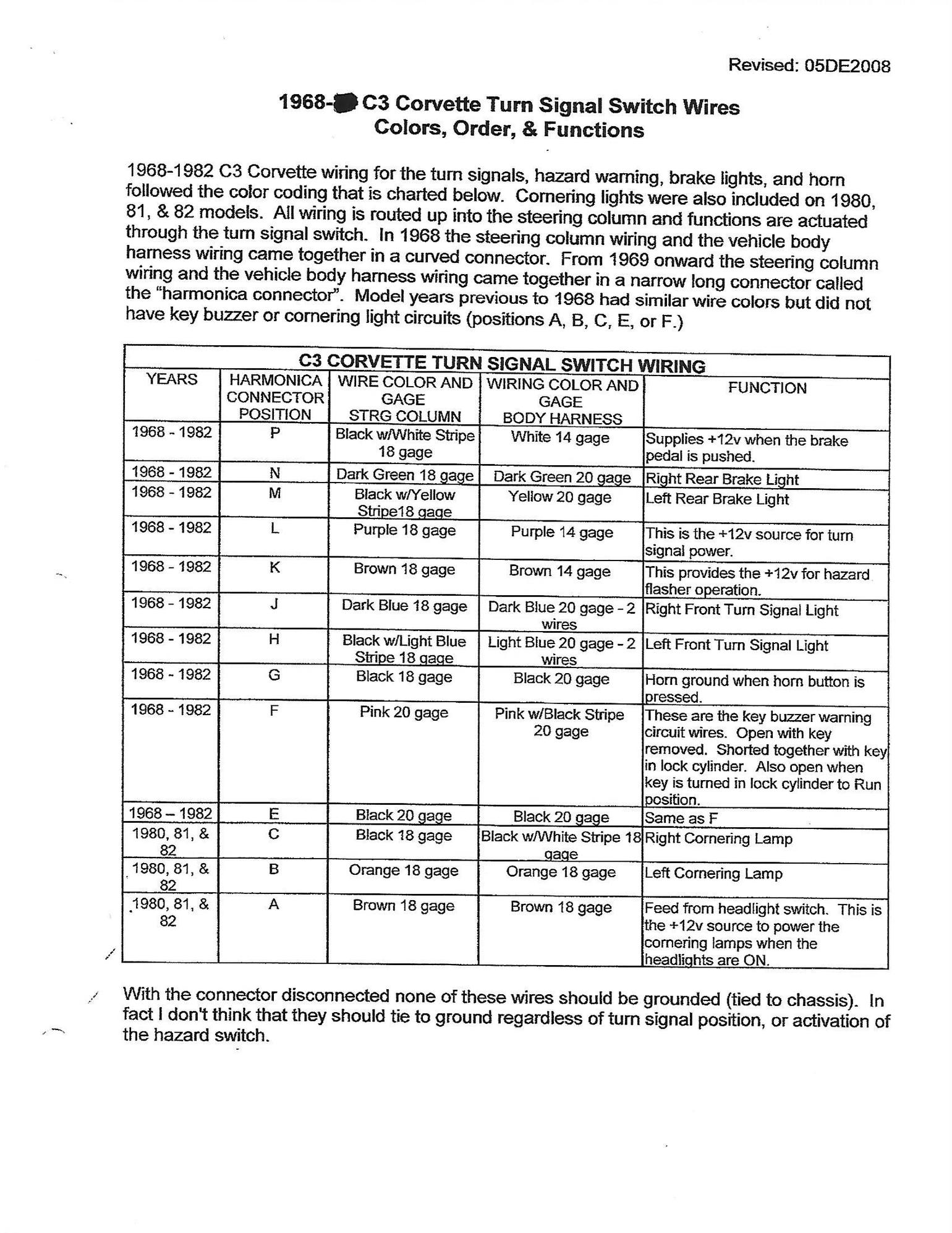

Trying to chase down a no right brake light/turn signal condition on my '75 Coupe.. It's a dark green wire at the rear by the lights, internet research leads me to think it is also a dark green wire at the harmonica plug by the steering column? Can someone confirm that this is correct? I have juice on both sides of the harmonica plug on the dark green wire ( when brake is pressed),but no juice at the brake lights, and no juice in that wire around the right rear wheel well. Just want to make sure I'm chasing the right wire?

'75 schematic:
https://docs.google.com/viewer?a=v&p...WRiNTdjNjdkNTQ
Make sure that you have a good ground at that socket.
Run a wire to a good ground and the other end of the wire to the brass as shown.

Confirm that you have power in and out of 'N' at the harmonica connection.
If good there then look behind the left kick panel and check for power in and out of the 12 point connector.
If good there remove the sill plate and check the wire for a break.
