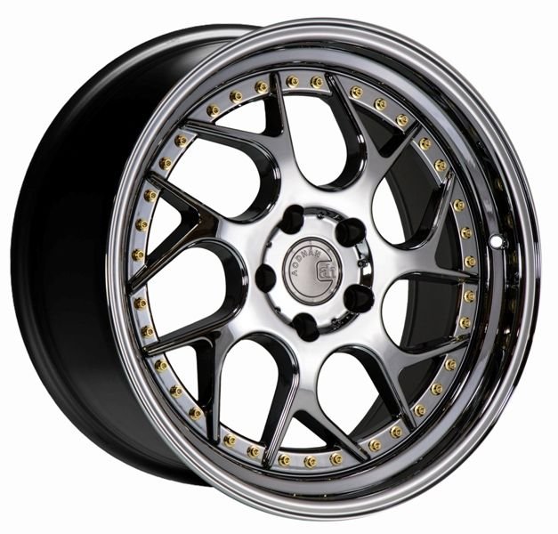

So I've been searching for a new set of wheels and tires for my 68 and I came across the Aodhan DS01 which comes in
18x10.5
ET25
5x120
CB (Centrebore) 72.6
I spoke with the rep and he said they can drill the wheels to match the bolt pattern of my 68.
Would these wheels fit my car? I'll be adding spacers for sure, front and rear. The rep did mention that this would be an "aggressive" fitment but I'm not sure what that meant.

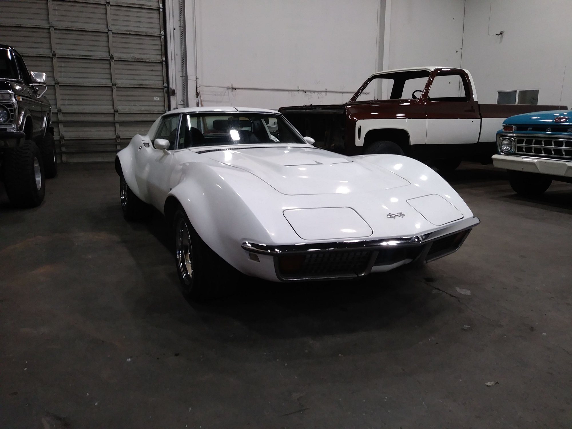

My car car has huge flares so that’s why I was considering the lower offset wheel.

25ET means a 6" backspacing for a 10.5" measured wheel, 11" for whole barrel width.
Take a ruler and a strait edge to see if a 6.5" will interfere with your trailing arms and if 4.5" front spacing will fill those flares the way you want.

They also have the option of +15 which will push it even further out. I will be needing adapters for sure. Just want to make sure they will bolt up to my car.

This is the wheel I’m talking about. I know since it has just over 6” if backspace it will interfere with clearances. That’s why I was planning on having a set of spacers made to accommodate. Likely 3” spacer rear and 1.5-2” front.
Its not a custom one off wheel. It’s a mass produced wheel, they only thing custom is that they will drill out to give me the 5x120.7 bolt pattern because they don’t have it. They also said they will provide hub centering rings since the centre bore of the wheel is larger than 70.6, I believe it’s 73 or 74.

It’s hard finding a wheel that looks nice and won’t break the bank. I’ve looked at some that have the massive lip but they’re ranging from 500-800 a piece! This whole set of wheels willl cost me about 900. I think the black chrome will go nice with my white car.
