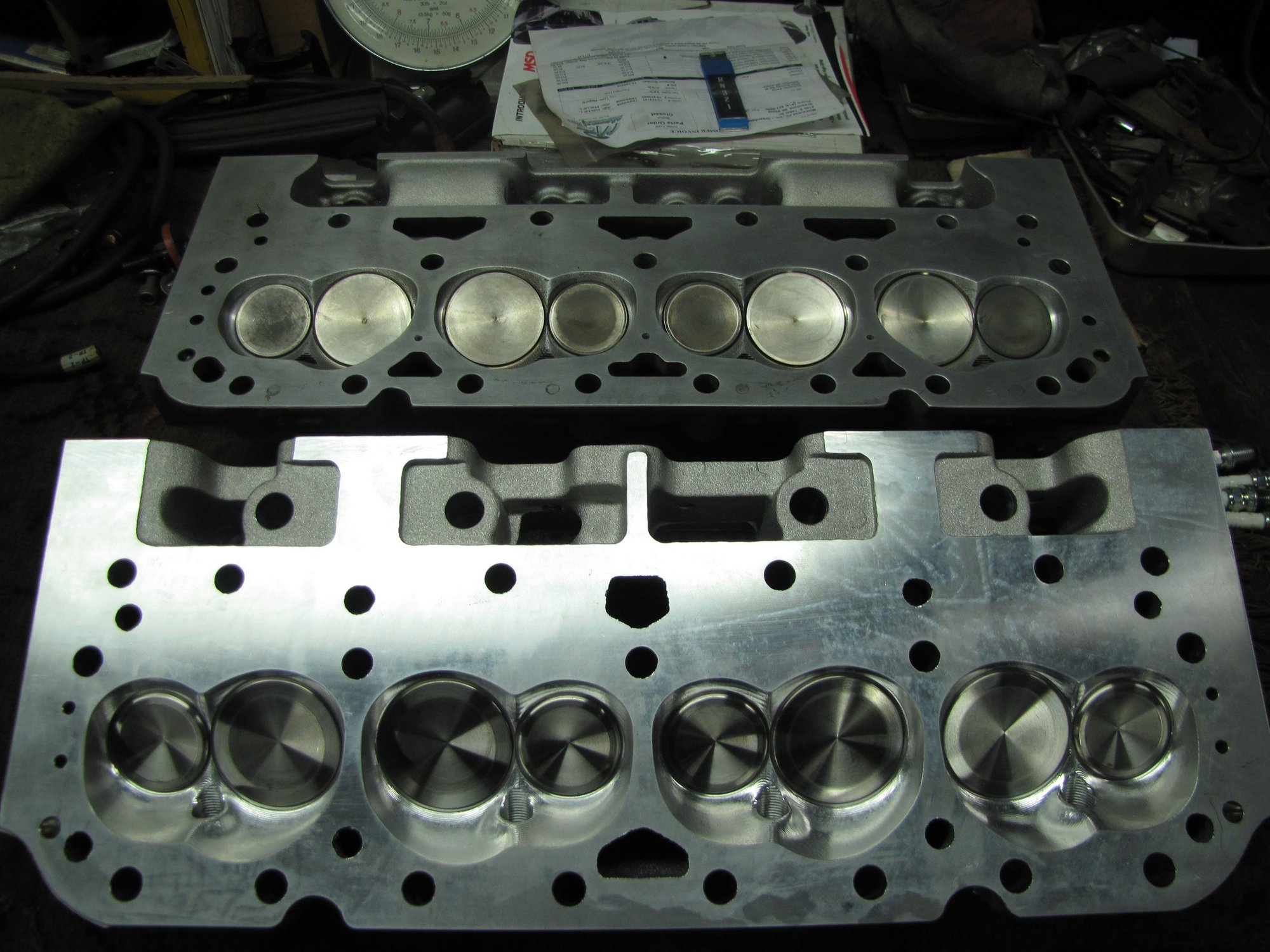

Had a pair of Dart Pro 1s on the engine in the bluecar. The cc chamber was too small for the next engine project so I got a pair of AFRs. The porting on the AFRs was a lot better along with the combustion chamber machining that the Dart heads. The performance of the Darts is outstanding, had 411 RWHP with that build [357 cid]. The Pro 1s then got duty on the 9-car engine [434 cid] and run great. The AFRs that are in the blue car make that engine into a brute and also look great with the bold AFR letters embossed on the ends. T
