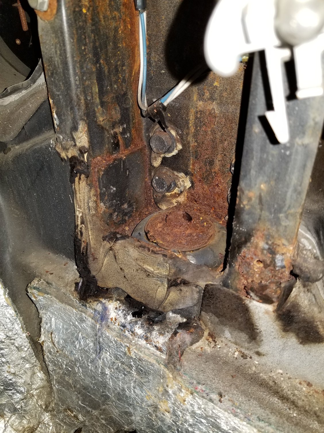

Yep its a project , but with the history you have with it , its the right project for you.
Looks like it was under a car cover or tarp outside for a long while, from how the paint has rubbed off the edges of the front guards ,sitting on grass /dirt? Anyway it doesn't matter now except to dig deeper into it to determine how far RUST has developed into the birdcage (if at all ! ) To me there's no point fixing it up to drive if the Main body structure is rotted away, as fixing THAT could take months in itself .
First thing I would do is take those kick panels off and have a look at the body mount bolts/area . Take pics and post them back here , IF that's rusted out ,the guys on this forum ,who have done rust repair on these cars can give you advice on how to proceed.
Very good idea to join this forum

Back in about 2005 the paint was actually in pretty perfect condition. The lines I am not sure what they are, but they were pealing. Unfortunately, this car was operational and it was parked on my parents old driveway. Someone covered the car and the minivan with what appeared to be baking soda and then covered it in Vaseline... when it was cleaned off it looked like this. I am good with removing things and putting them back together, but I do not know the name of a lot of the parts. I would assume the kick panel is in the interior by where your feet would be located. I found a picture online ( the one below, but until i get home I am not sure where it is.

Yes they are the kick panels and you assumed correctly

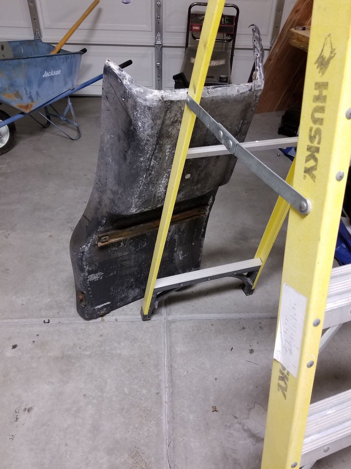

Here is the new pan I picked up... And the pictures you requested. Should I get in there with a Razer and clean the inside or does this tell you what you need to know?
New floor pan
Underneath of new floor pan
Driver side kick plate ofd
Driver side kick plate off
Passenger kick plate off
