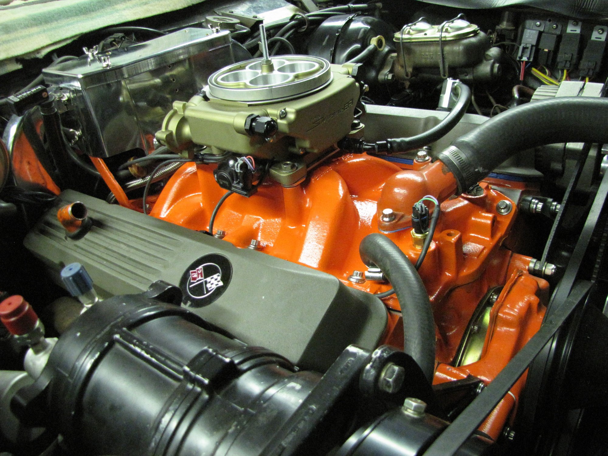

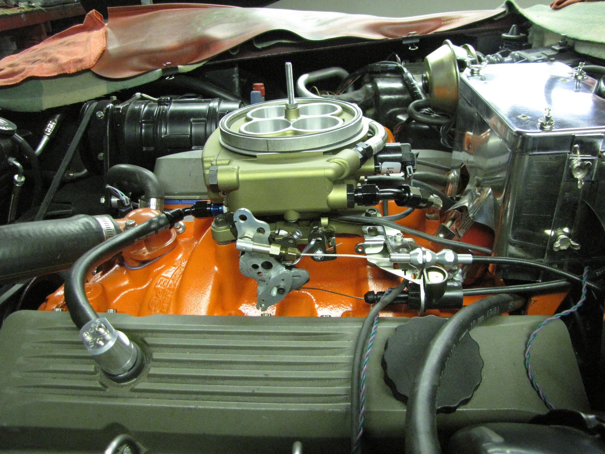

The 69 just got the Sniper upgrade. I used a separate regulator mounted back at the fuel tank [thanks Redcruz] to eliminate the second fuel line, needed to relocate the rear right port to front and have the pressure line to the left rear. Needed a 1/4 inch spacer on top of EFI as you can see in picts. Using original 1969 air cleaner housing. T
