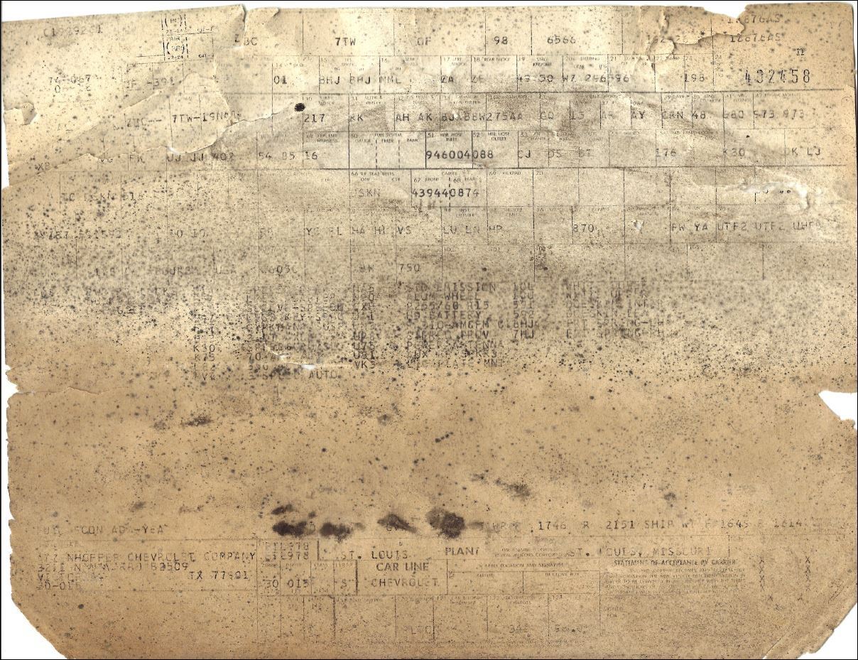

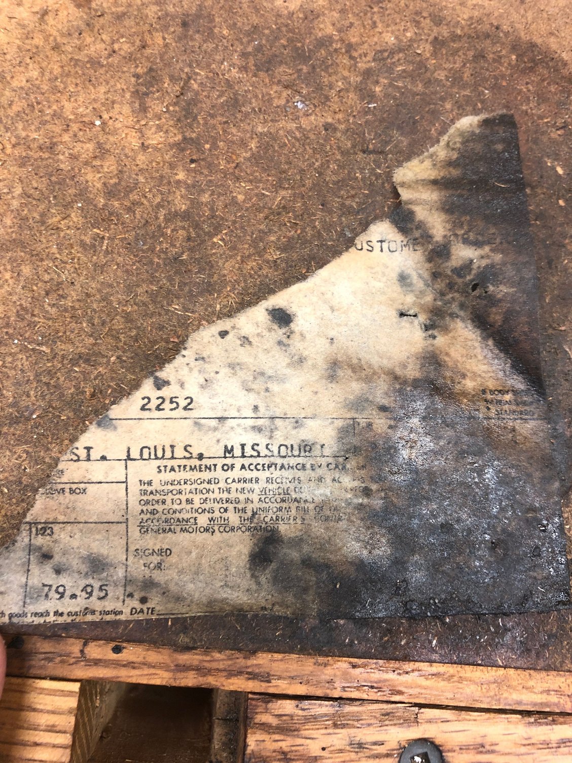

I had some funky sounds coming from that heat shield also. But I stuffed a bunch of insulation between it and the diff housing and that stopped.
That scrap of paper is definitely part of the build sheet. I found mine still attached and almost 100% intact on top of the gas tank where it had been for about 38 years.
Here's a photo
Here is what I first saw, a section hanging over the gas tank
whole sheet
