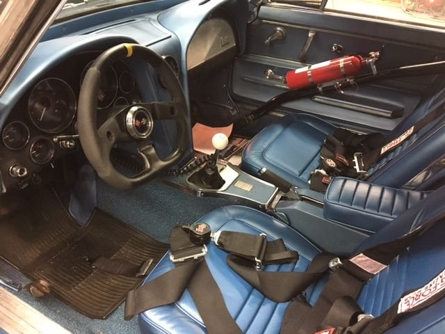

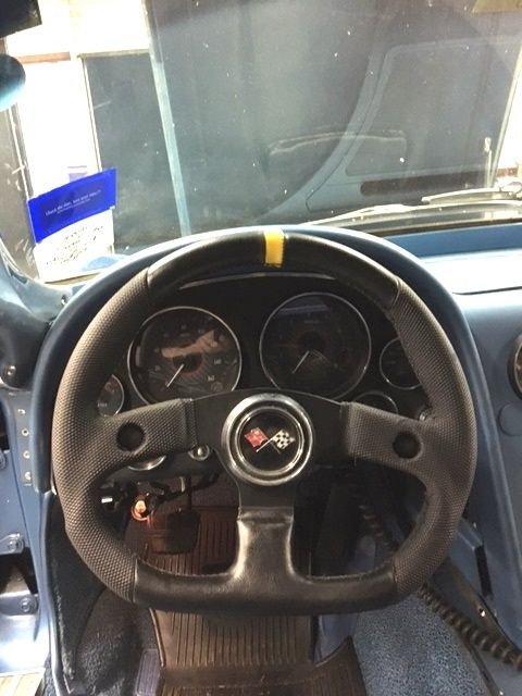

Not exactly what you mentioned...but here's what I installed in my C2. I have a 6 point rollbar and getting in and out with racing gear on is easier with the D-shaped wheel. Prior to this I just had one of the smaller leather wrapped ones.
This wheel fit by utilizing the old wheel as a template and drilling the mounting holes. The original horn button even works.
C2 columns have some built in adjustment fore/aft to allow some room...but I took mine even further and shortened the shaft itself within the housing so I could get my arms stretched out straight like I prefer to drive.

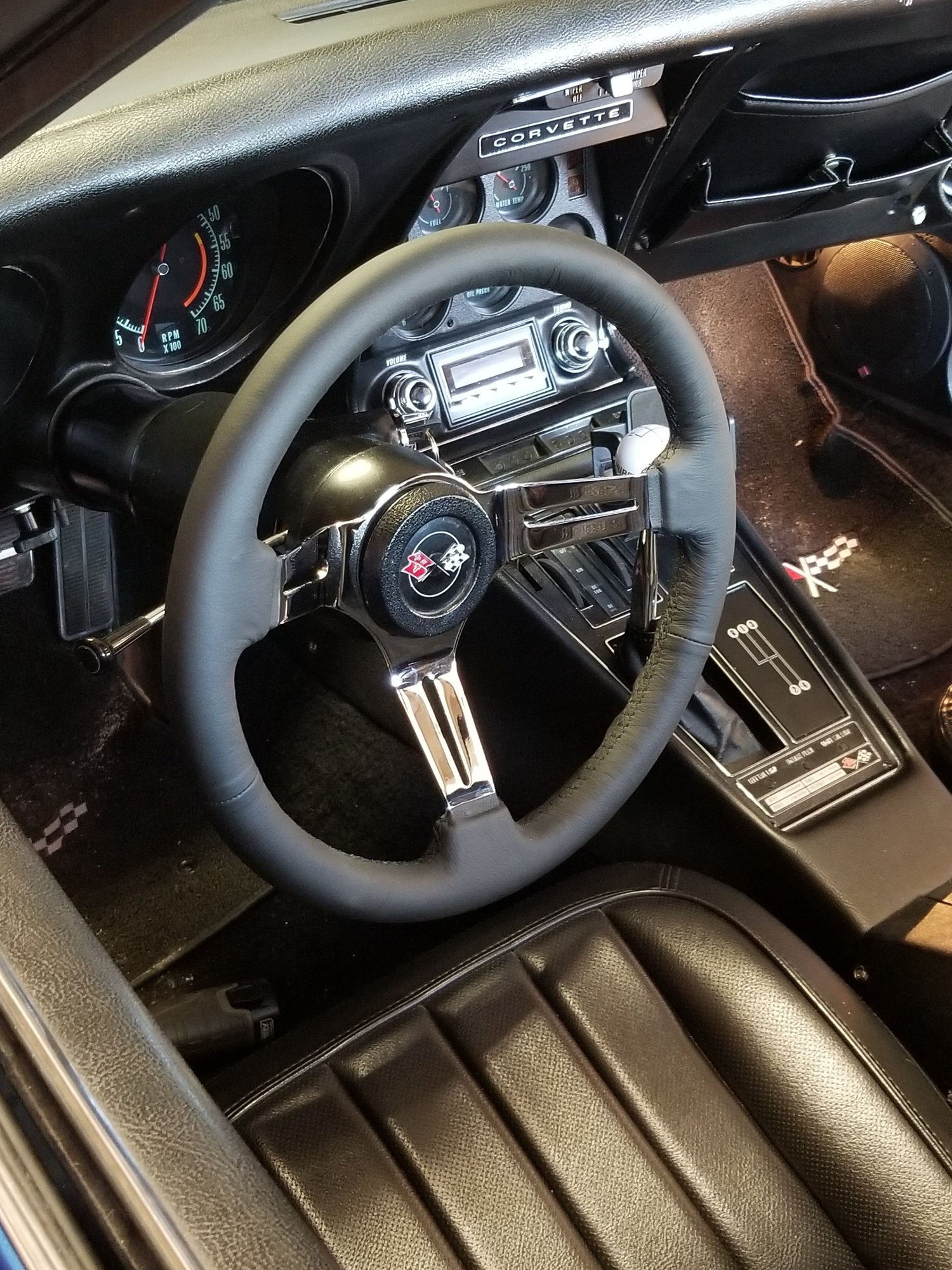

I got the 14" from Corvette Central in black leather and chrome.
It's a 2 1/2" dish, by my measurement.
Looks nice and is more comfortable to grip than the stock thin wheel.
Only downside for me is the added obstructed view of the gauges, Especially affects the speedo at the top of the dial.
