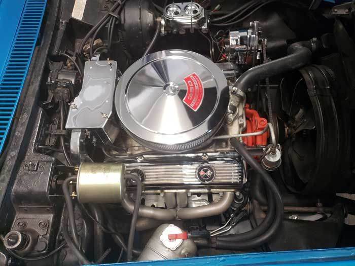

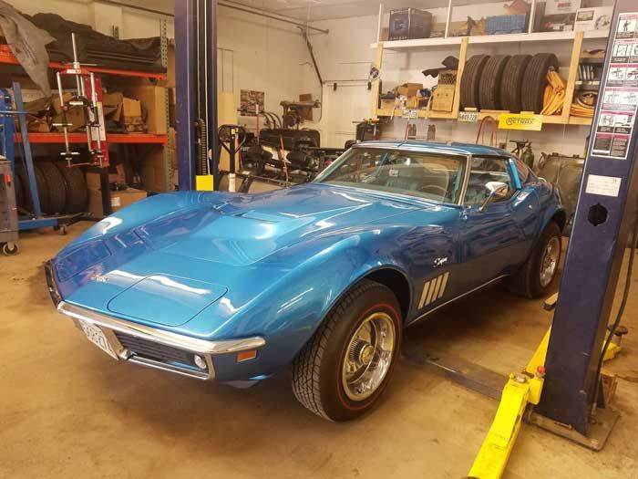

I brought the Corvette to the shop today and we've started the project.
Patient in the OR:
Patient being prepped for surgery:
With the hood off and some of the dress-up pieces removed, I had a better view of the numbers from the Edelbrock manifold and heads. The manifold is a 7501 and the heads are 6089 (since superseded to 60899, from what I can tell). More to come...
