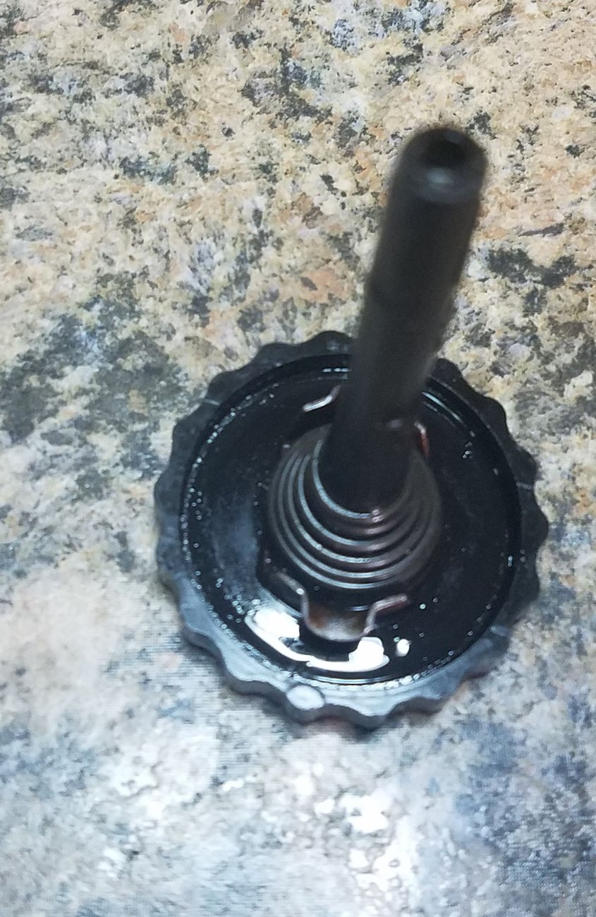

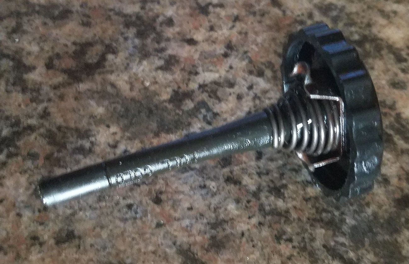

Upon further inspection, the cap doesn't have a gasket at all !!
This wouldn't allow the reservoir to empty though would it?
Anyone know what brand came on the 77? Not sure if it's original, but I need a place to start. Maybe ACDelco?
Also, that bolt I mentioned only has a washer on it, no o ring. It's just strange that when I take it out nothing comes out behind it. lol
I've attached some pics.

I believe the original pumps were mostly "Saginaws". But I have seen different filler necks on some pumps. Some were so tall it would be impossible to get at the dipstick cap. Just for the heck of it, go to NAPA parts on line. Enter your yr, make model, search PS pumps. See what they look like from them. I got a rebuilt from NAPA. Its just ok. Seemed to leak too soon but is a exact match and I have EASY access to the cap.
As far as a cap gasket, that shiny part under the spring is more or less a seal. I went one step further and bought a sheet of FelPro Cork gasket maker. Tracing out the cap size, I managed to make a better gasket. Then I recall it was glued under the cap with Permatex Black. Made a big difference in splash, mist, vapor or what ever you want to call it, coming out of a poor fitting cap. It seals tight now.
