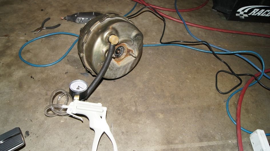

Originally Posted by mobird
Can I test it by hooking my vacuum pump up to the line as shown in the picture below? Because when I do I get no vacuum at all.
Here is how to tested my Booster. You can do the same while on the car. This unit I was not able to get any vacuum build up. The replacement I could easily get 18 HG and it would hold it without a noticeable change after 60 minutes.
