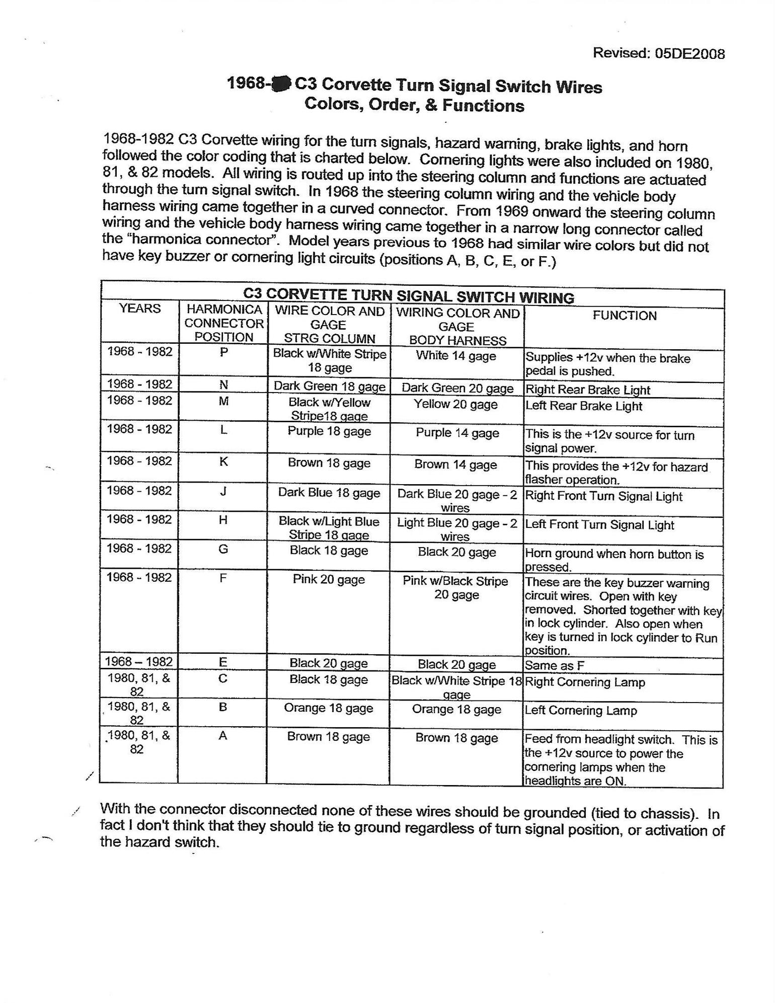

At the harmonica connection at the bottom of the steering column make sure that you have a good connection in and out at the yellow wire at 'M'.
The next connection is behind the lower left kick panel.
There is a nine pin connector, check that you have a good connection in and out on the yellow wire there.
https://docs.google.com/viewer?a=v&p...2IwMmEzZDkyY2M
