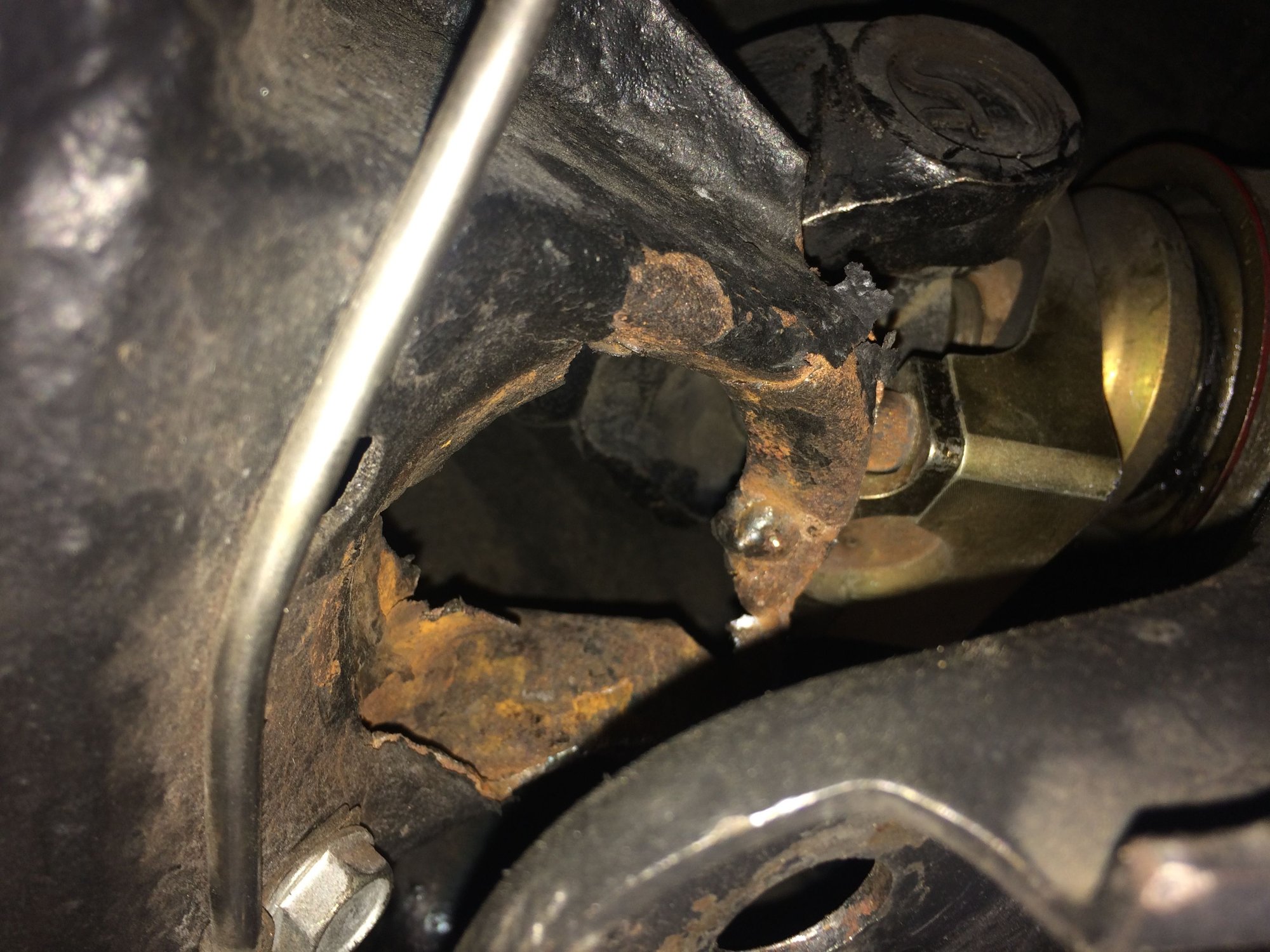

Yep, happened to me when I downshifted to 2nd, showing off to my gf.
I don't suppose someone makes a replacement bracket. The snubber pulled right through it. And the car is basically rust free.

The bracket welded to the frame ? we broke one before on our 75. The bracket can be cut out and a new one welded in place. You should be able to get them from most vendor. Calendonia corvette used to make them.

I actually found a new bracket at Corvette central. Thanks

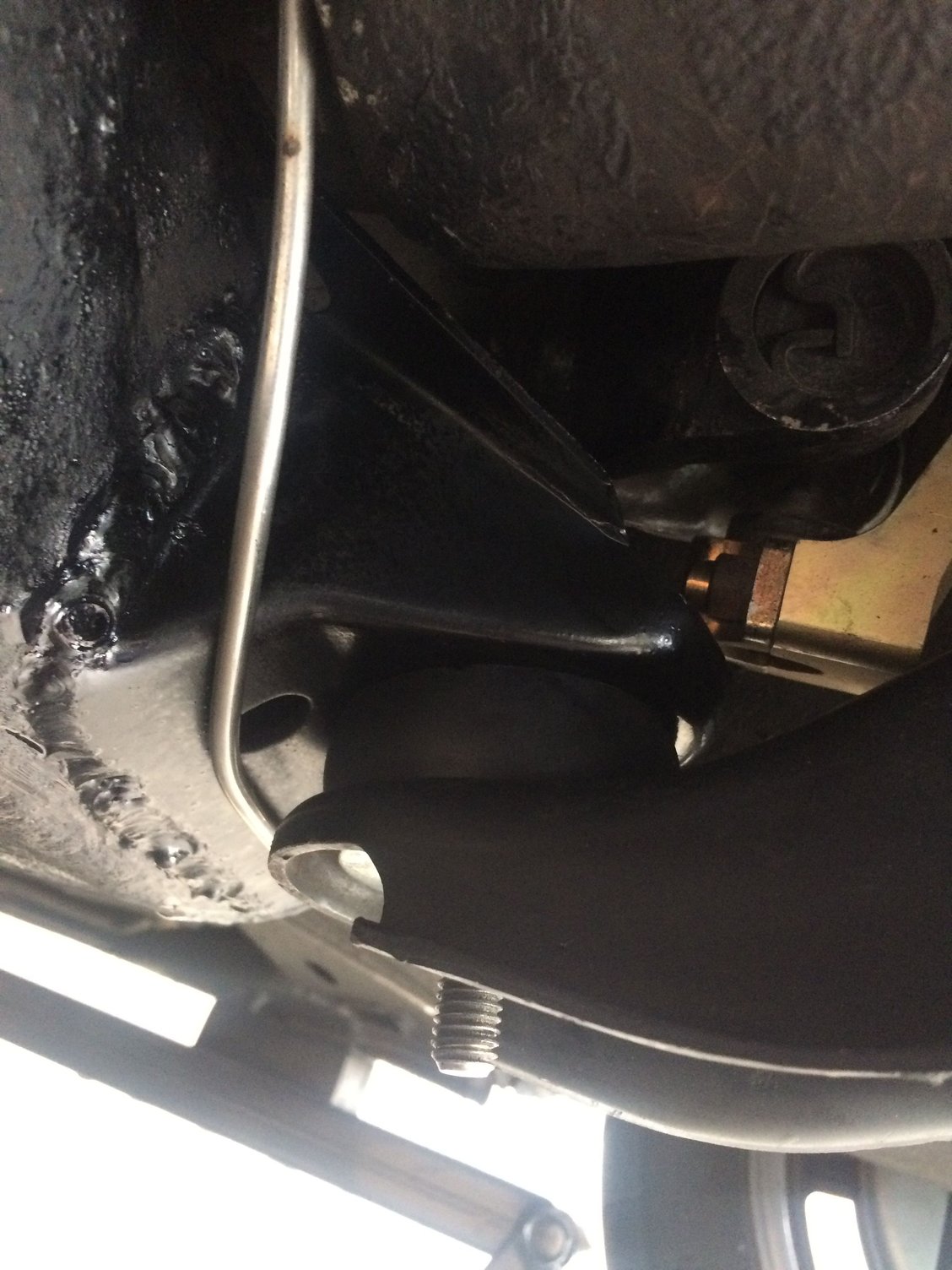

Repaired.

Nice repair
