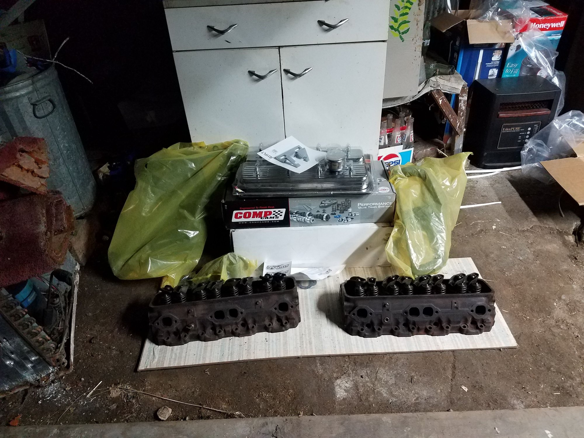

Hey all long time reader brand new member. First of all I would like to say thank you for all of the useful material that you offer here at this site it has been a huge help to me so far in starting into the world of Corvettes. I just bought back in February a totally stock 1977 Corvette with 65000 miles. I am always wanted one as a kid growing up and finally had the opportunity to get one. I have ordered a lot of parts to start doing upgrades I am curious if there is anything that I need to look out for when I start swapping things out and and also what kind of power and torque do you feel like I will be getting?
First first of all I bought a set of 062 Vortec heads
*Comp cam Xtreme Energy Cam and lifter kit with the following specs
Duration at 050 lift. 218int./270exh.
Advertiaed duration- 262int/270exh.
Intake valve lift w/ factory ratio rocker arms- .462int/.469exh.
lobe separation 110
Grind number- CS XE262H-10
oustide diameter of outer springs 1.254in.
*I also have already bought summit vortec dual plane intake manifold
*Edelbrock 1405 600 cfm carb
summit racing G9003 full legnth headers
Finally Patriot exhaust 60 in side pipes.
One big question is can I use the push rods from my L48 heads or do I need to order some aftermarket ones... I feel like based on what I've read I should be fine but would appreciate confirmation.
about where do you think I will be horsepower, torque and compression ratio wise?
Finally, do I need any shimmed head gaskets or anything like that or will the standard let's say felpro work fine?

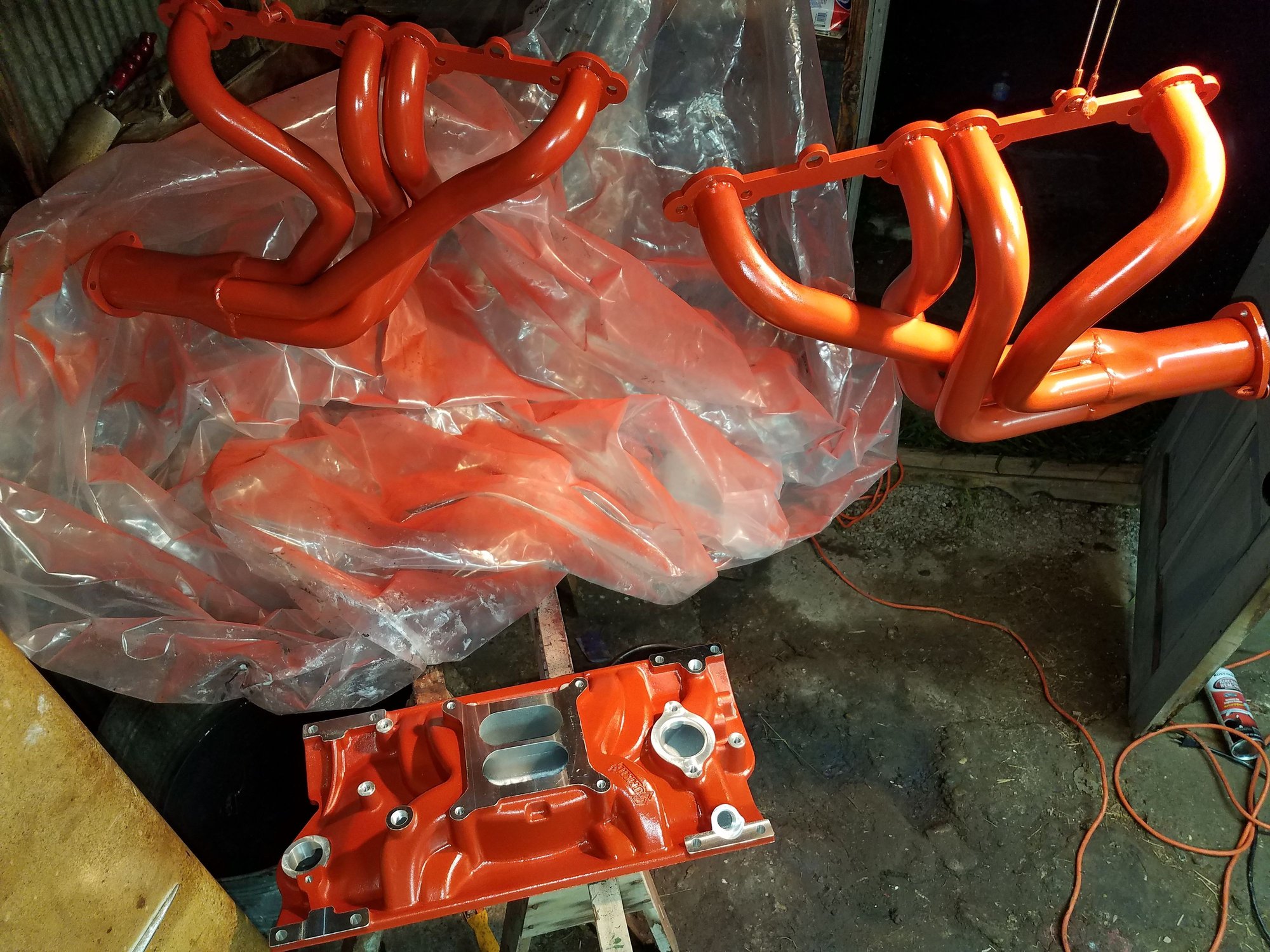

What did you paint your headers with? I have never had any luck with painting headers, the high temperatures coming out of the head burn the paint off right away. If you have any problems with burn off you could get them coated for a couple hundred bucks in a variety of colors during the winter months. Currently I have a set of Hedman headers that came with the silver/chrome coating on them. The aftermarket coatings can reduce your engine compartment's temperature.
You did a beautiful job painting your intake manifold! When you finish the engine as you described it, it should be quite the looker as well as a performer! Car shows here he comes!

Hey, no worries at all what you were proposing is a great idea and I plan to incorporate it into my big build over the next few years. I'm hoping to just bring the old girl to life so I can enjoy it more while building my 500hp plus (goal) engine. I plan on a 383 with a roots super charger and the biggest cam I can cram in it lol. I'll be doing a 4 bolt main for that build and pairing it with a different tranny and rear end set up. As for the paint I used vht high temp bright red for headers and the intake. The heads will be painted to match once they come back
​​back from the shop as well. I live in Maysville ky so a trip to PA isn't out of the question as I have family in the Morgantown WV area. I'd love to make it up there next year if I can manage to at all. While I do that engine I may get froggy and do the bottom end later on the current one with new pistons and what not down the road a little ways. If all goes well the block will be going to the shop(cropper race engines is the shop I am reffering to in case that means anything to anyone here lol) to get the cam and heads assembled and checked next Friday. They will be checking it with clay as well to ensure proper fitment Should have it all back together with a couple days to spare before the event (fingers crossed) lol thanks again to all of your all's input and tips it has helped me tremendously over the past few days.
i attached a better picture of the manifold in case you were interested in seeing it
