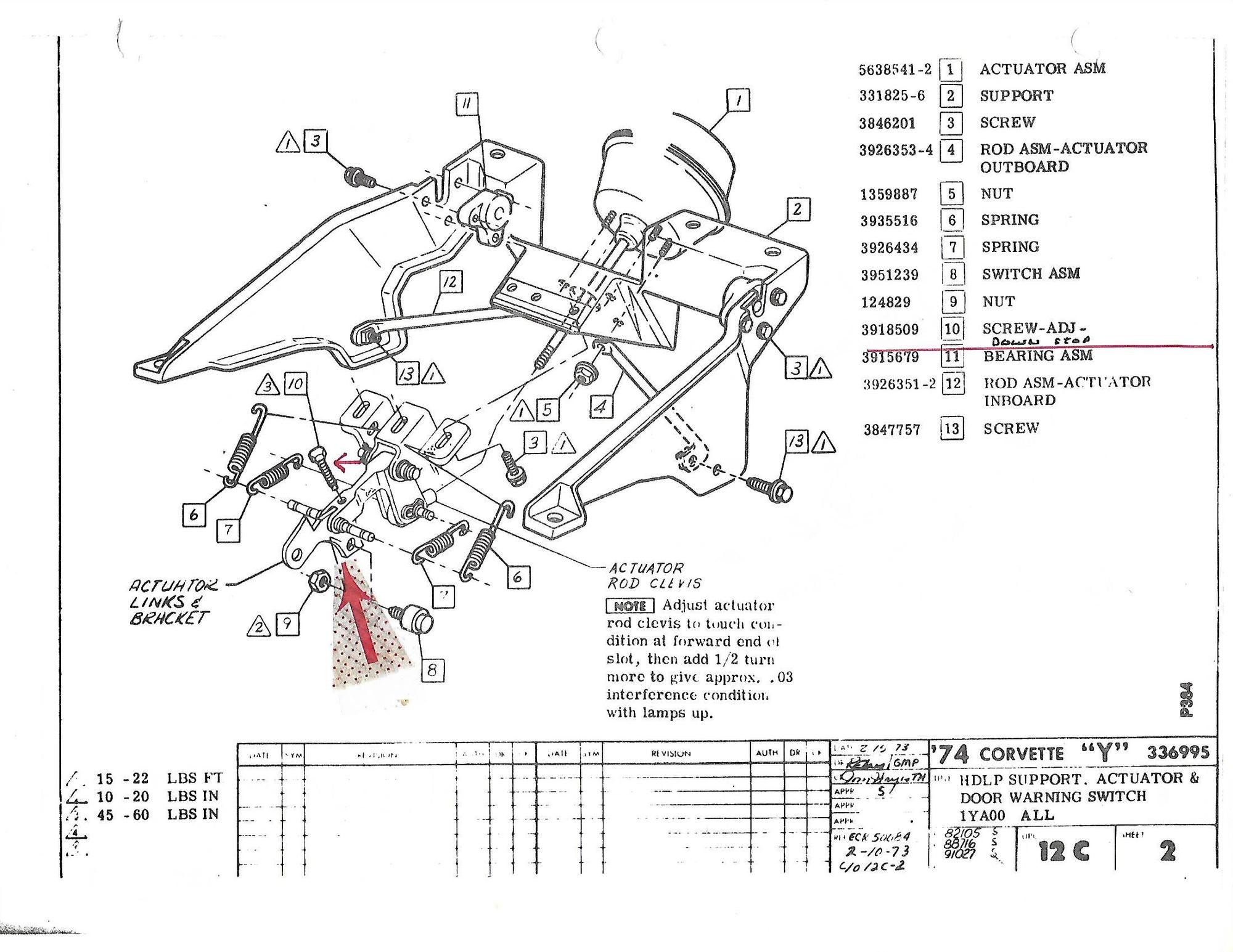

If you just want to close the headlights temporarily go under the front and pull down as shown.
Many times a bad seal (grommet) is the problem.
Go step by step and test all the parts:
http://www.corvette-101.com/vacuum.htm
