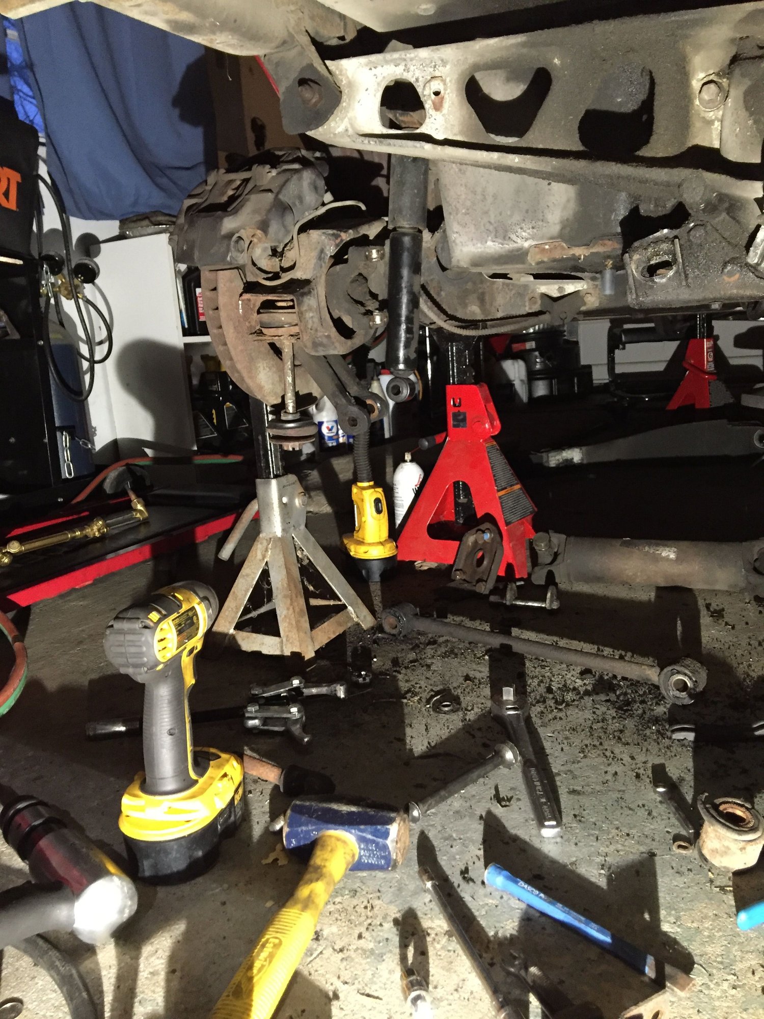

25 years I have been working on cars, and I have NEVER encountered anything as frustrating as this trailing arm Job.

Keith, if when you reassemble this you use antiseize on the all of the threads and the shaft's of the bolts that slide through the strut rod bushings and trailing arm bushings these things will come apart in 10 - 20 years as easy as they go together. Unfortunately, I have yet to take an original one apart and found any trace of antiseize on any of the parts.
Moisture gets in the bushing between it and the bolts, and since there is little if any movement of the inner bushing and the bolt they rust together over time. This is an area where anti-seize is definitely your friend.
One other thing, and you may already have noticed this, but just in case you didn't, the shock mount has a flat on it near the threaded end (of the portion that goes through spindle bracket). The ears of the spindle bracket, that the shock mount slides into to carry the strut rod, are not round all the way through. One of the ears (the one to the back, closest to the spring bolt) has a flat in it that the flat on the shock mount slides into. This is what locks the shock mount from turning in the spindle bracket. The shock mounts are marked Left and Right so be sure you put them in the right side. Otherwise you'll never get the shock to slip on the mount and you'll be taking everything apart again to swap them.

Originally Posted by jim-81
Here is the carnage from my shock mount removal adventure. Torch, air hammer, BF hammer, beer
I remember doing mine years ago. I think it was like 8 hours per side using the shock remover tool, BFH, torch,...and the ultimate tool......sawzalll. That and the appropriate amount of beer
I recently discovered a new Sawzall blade, I think it's called a Diablo. Used it to cut 3/8 inch thick plate steel like a hot knife through butter. Wish I had one back when I did the T-arms. Would have cut them both out in ten minutes.

I just went through removing the rear shock mount. I tried the penetrating oil,, BFH,,, my old air hammer,,,3/8 inch cap, torch heat,,, ETC......... Nothing worked..... I borrowed a friends SnapOn $600 impact hammer. It took 10 seconds to pound the shock mounts out. I drilled a dimple in the end of the mount for the hammer tool to fit in. Worked like a charm.... I banged on it with my air hammer MANY times,,,,, nothing. A more powerful air hammer made ALL the difference. I can see if you get to crazy with a big hammer,,, you are going to destroy something.
