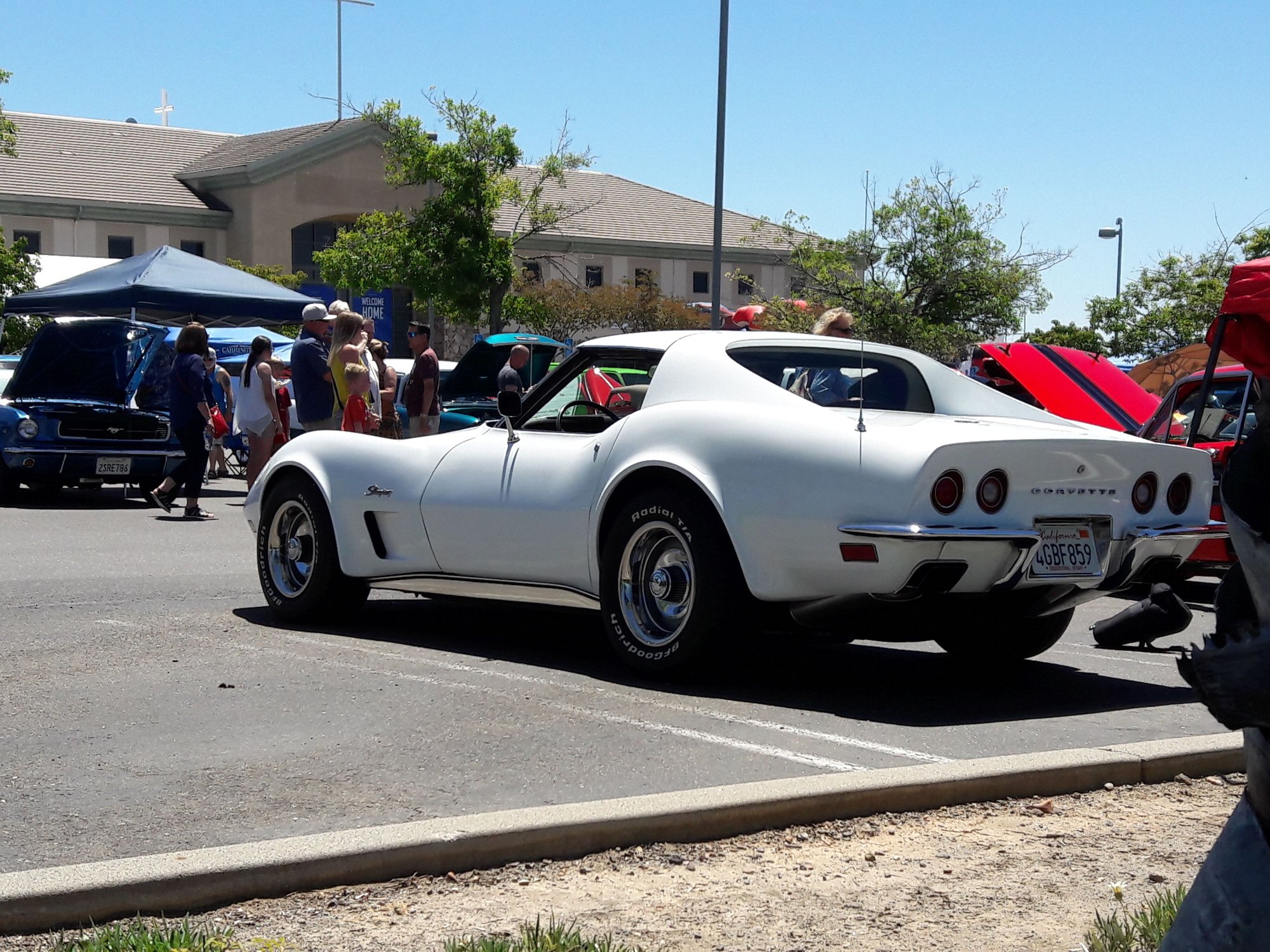

Here is a little advise and a little opinion on my part.
I looked for a numbers matching corvette when I started to look (original matching engine, trans, rear end, parts and components).
I wanted a 68-72 but what I found in my budget were mostly hacked or "slightly modified" junk.
They looked nice in photos, adds, but in person, the work done needed to be redone.
I came across my 73, it was numbers matching but things like calipers, rotors, water pump, alternator, radiator, ignition and other maintenance items had been changed by the original and prior owner.
The prior owner had all parts and maintenance records for him and original owner regarding what work had been done and receipts for all parts and labor which was very important to me.
Most important, the car was always a California car and I would not consider a car from anywhere but from the western most part of the USA, again my opinion.
Why? we have a very dry environment, which can mean very little or no rust.
I have seen first hand what hack jobs have been done to cars, motorcycles and boats in general when some hack swaps out a motor, trans rear end.
To me the condition of a well maintained corvette that was as close to all original as possible was most important.
When I looked in the interior, it was spotless, well maintained, clean and all original.
Popped the hood, and the engine compartment was clean, original, not re-painted or fluffed up by detailer's and no added chrome goodies.
The paint was redone about 20 years ago in the original white and still looked good. There were a few imperfections in the paint like rock chips and scratches.
Crawled underneath, and found some VP&B upgrades, clean of oil, grime and no fresh paint.
I paid about $2500.00 over what the car was worth on paper, but to me it was worth it.
I've been driving it trouble free for two years and purchasing parts for a body off resto/mod soon.
If it were me, I would considerate on how to the car to Switzerland, then find a nice driver that you can restore and enjoy.
Stay away from dealers who deal in flipping corvettes (buying, detailing, swapping in create motors, painting and selling.

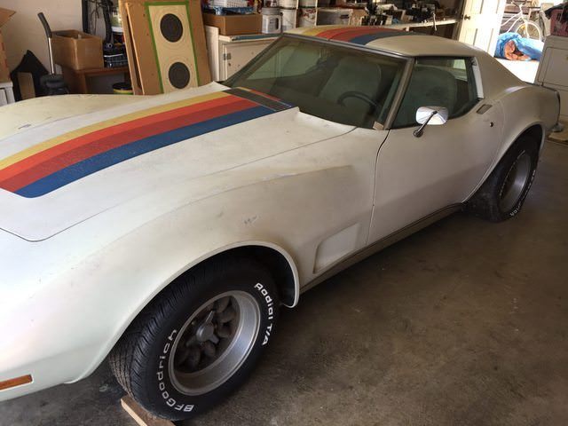

Good advice right here
That is exactly what I plan on the 73 I just bought to look like when I'm finished including the color. I found an all original intact California car for $3,500. It has been sitting for 20 years. It will take some work and cash but they are out there.
