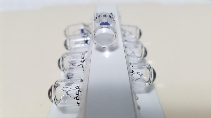

The good bulb number is a GE 558. The bulb has a magnifier built onto the end of the glass. Not sure what manufacture but Willcox sells them.
https://willcoxcorvette.com/corvette...l-center-77-82
End view:
