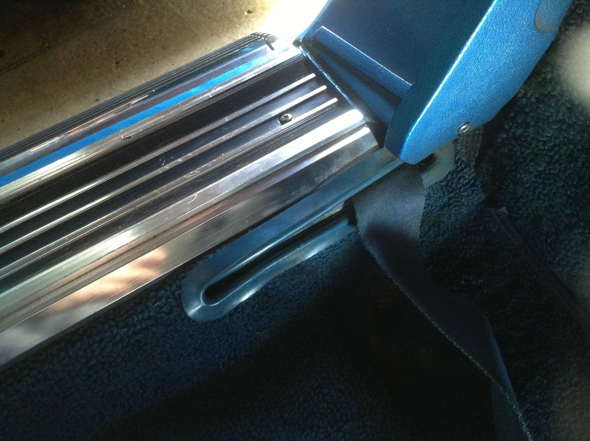

Hi guys, has anyone installed seat belt inserts and has a picture of it? I am in the process of installing my seat belt guides on a 69 corvette and bought a pair of those rubber inserts and wondering where and how they are installed.

Yeah I figured as much I just wanted to see a picture of it in place , also makes me wonder why GM made the inserts so big when the seat belt is only 2 inches wide. I am hoping that someone has a picture of them placed on the carpeting.
I'll post a pic in the next post. I have to switch devices to post the picture. But I can tell you the rubber repros are pretty bad. The originals are hard plastic and stapled in place from underneath the flap. The repors are hard to get in and to make look proper. I have installed the repros. All I can say is...GO SLOW..I actually used some silicone to glue them in place. Go slow with cutting the carpet. Cut a little each time until you get a snug fit. Since the repros are rubber, too snug a fit will bend them. The original plastic guides are much more forgiving when being installed.

Old Aug 17, 2018 | 10:50 AM

Thank you very much for the picture and information. You would think it would be just as easy to make the plastic ones like original as the rubber ones.
I agree! By the way, the picture above is an original set as installed, untouched from the factory for a mid Jan 69 built car.

my 1969 is from November 69 and that is exactly what they look like, even the color.

Thanks for all the help, was the carpeting cut to the whole length of the insert opening? Or just enough to accommodate the width of the belt?

The carpet is cut the entire length.
