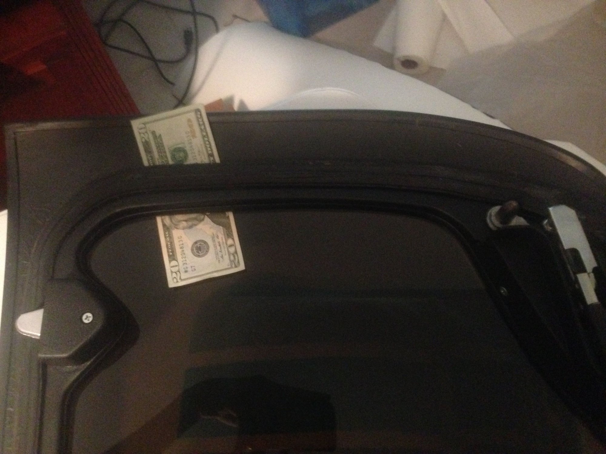

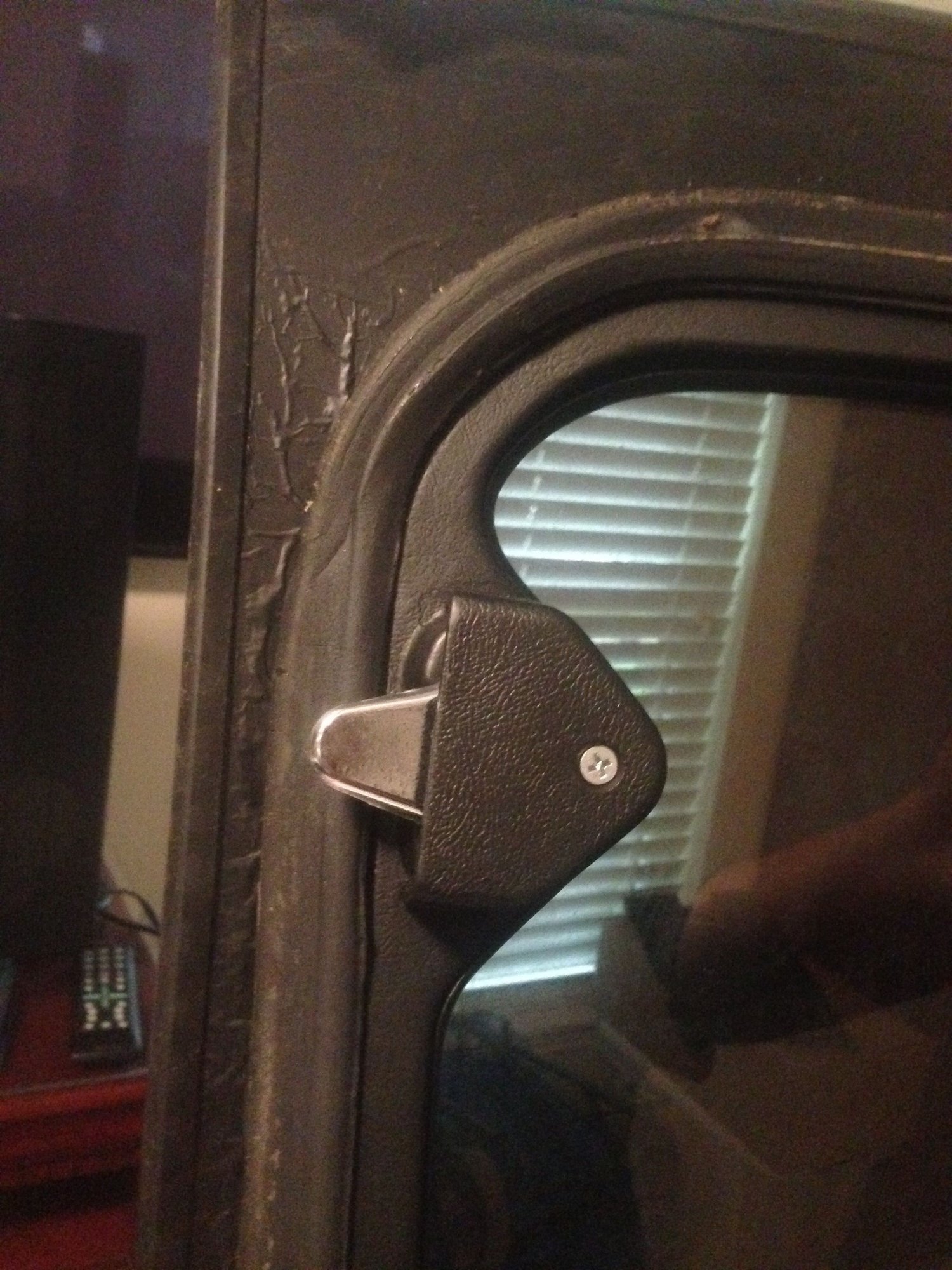

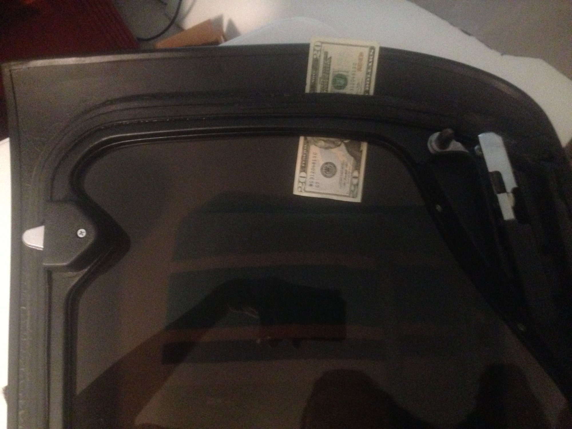

I called hoping they could just reglue the frame to the lens, my lens is in great shape, but I was told my lens was sun damaged even though he did not have any way to look at it. The tops are 9 yrs old but I have not taken a close look at them for ages so these failures have likely been there for some time. The weatherstripping cracks in 3ish years or less, there is even a thread I found where willcox said they do not use the top of the line weatherstripping which can cause window alignment issues as well. Its not easy to tell when the lens starts to separate, you have to get up close and personal to know for sure but slowly over time your car will have more wind noise and water leaks that wont be super obvious because they happen overtime and not all at once. I imagine there are many happy customers who probably store their car indoors and do not have these issues. My car was under a carport under a car cover and driven 10k miles in 10 years and I have had these issues so if you are in similar conditions I would expect similar issues.
I would like to discuss the reasons these issues exists and why their one piece tops have such great reviews. If you look at the c4 forums there are a lot of unhappy customers who have the oem style rebuilt tops. The issue I see with the c3 tops for starters is that astro tops uses paint to black out the area surround the original frames they use and this paint cracks because it doesnt expand at the same rate as the lens. On original glass tops they use a vinyl sticker for the blackout areas. Another issues is that the acrylic lens expand and contracts more that glass does stressing the bond areas more than oem tops. I do not know the primer they use for the areas where glue is applied on astro tops but these areas failed just as much as the painted areas. Another issue I see is that there is zero UV resistant measures on the astro tops. I found primer that is meant for acrylic/plexiglass for boat windshields (sika primer) which seems very high quality but they even mention that you should paint the outside of the windshield where the glue is to be applied so that it can block UV light hitting the primer and deteriorating it. If the astrotops used a clear UV blocking exterior window tint I imagine the bond would last much longer. I also imagine that the reason many OEM corvette tops are reflective/mirrored is that it blocks a ton of UV light and preserves the bond/primers for longer.

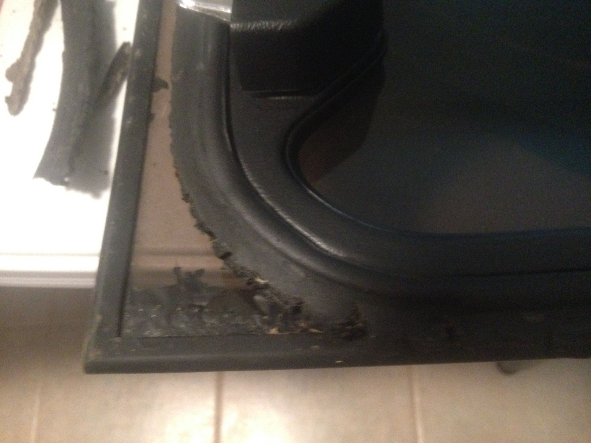

To remove the areas of the frame that were still glued, I used fishing line, guitar string and razor blades (only about 1/4 of the frame was still bonded) and in the end I just had to pull the frame off with force, the corner where the handle for the latch is has a lot of glue from astro tops so thatll be a challenging area for whoever tries to rebuild thier own top. Most of the paint flaked off of the black out areas, but what ever was left I carefully used a bent razor blade to remove the paint. This left scratches that I polished out with a harbor freight headlight polishing kit. I havent polished it out perfectly, up close I can still see sanding marks even tho they are glossy, the vinyl wrap will hide these althought on the second top I will try and find a chemical to remove the paint instead but it will be a lot of trial and error to make sure the chemical doesnt damage the lens.
The glue I will use will be some kind of black 3m urethane windshield adhesive and whatever primer they recommend for metal for the t top frame. The glue did not fail on the frame side although the glue used in some areas was thin and could be pulled off so I will make sure to use more than asto tops did in those areas.
