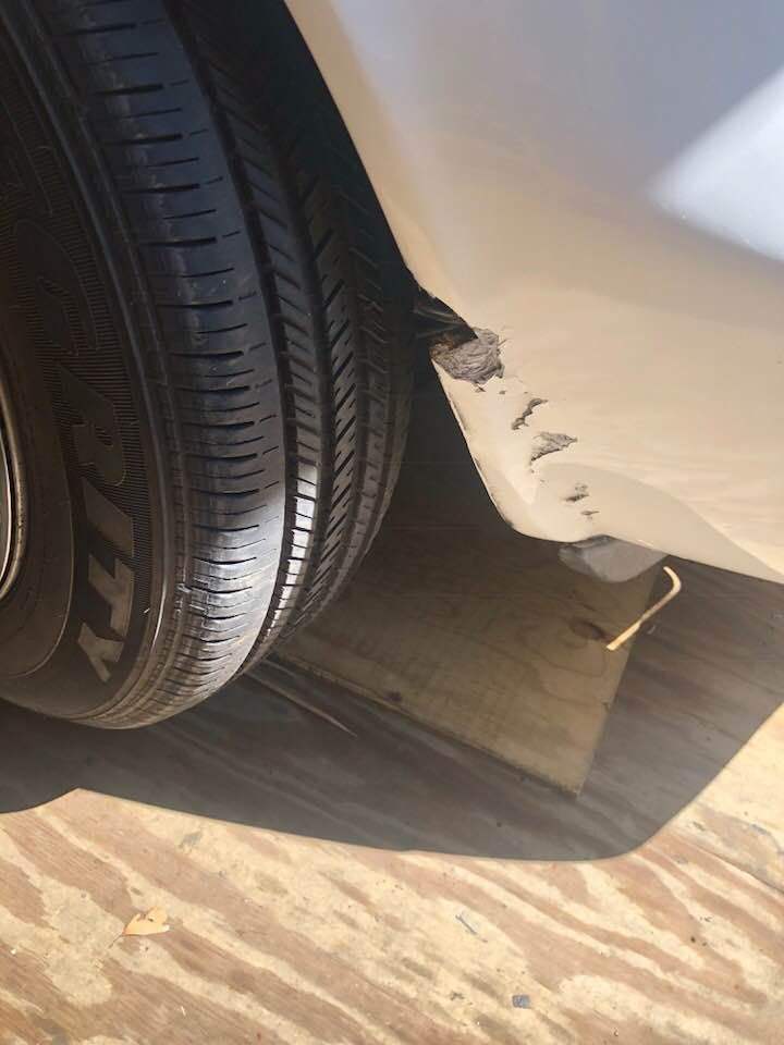

Drove the car for 25 feet and felt rubbing while cutting left. Backed it back into the garage, to find that passenger tire went through the fender.
About to give up and just cut my losses.

Old Aug 23, 2018 | 02:34 PM
lionelhutz's Avatar
lionelhutz
Joined: Apr 2007
Posts: 11,152
Likes: 890
From: South Western Ontario
Check the lower control arm mounting. The arm is likely breaking off the frame.
