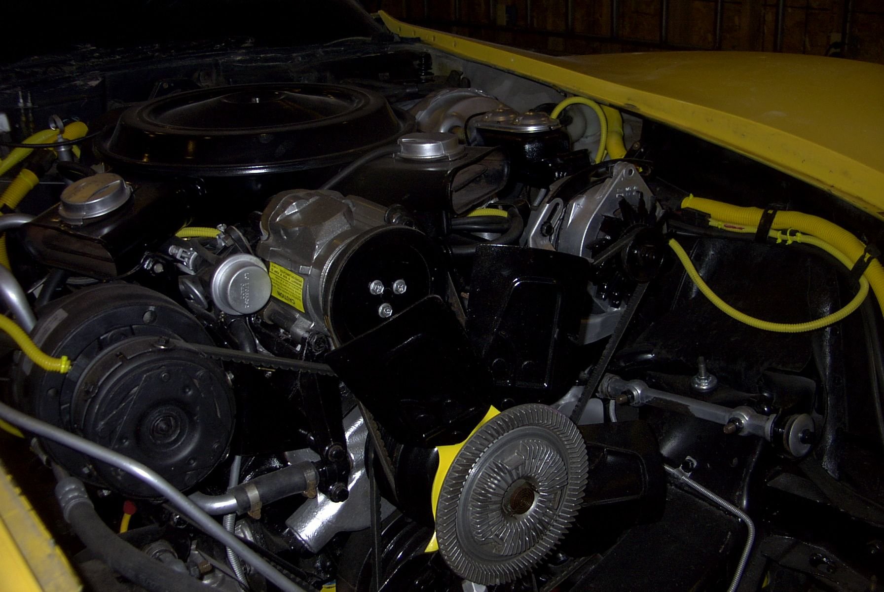

Old Aug 22, 2018 | 09:42 PM
cscaffidi's Avatar
cscaffidi
Joined: Dec 2006
Posts: 43
Likes: 5
From: hammonton nj
This photo is from after I cleaned everything up because it had just been sitting for a few years.
Guys, Thank you so much for the quick replies and advice. I have had this car for many years, but I hardly ever drive it. However, it never gave me any problems on the rare occasions that I did take it out. I got it about 25 years ago with 68k miles, and have put just 12k on it since. I've never added any zinc to the oil. Last time I took it out it started the backfiring, but nothing serious. It only did it when I really got on it. So I made the appointment to bring it into the shop. However, driving it to the shop it started missing more and more. According to the mechanic, when they took off the valve covers, the forward most rocker, on the #1 cylinder was not moving. When they removed the intake manifold, they said the lobe was shot and the bottom of the lifter looked damaged too. I am pretty handy with this kind of stuff, maybe novice level mechanic I'd say, so I thought maybe I could just change the cam my self, although I've never done one.
