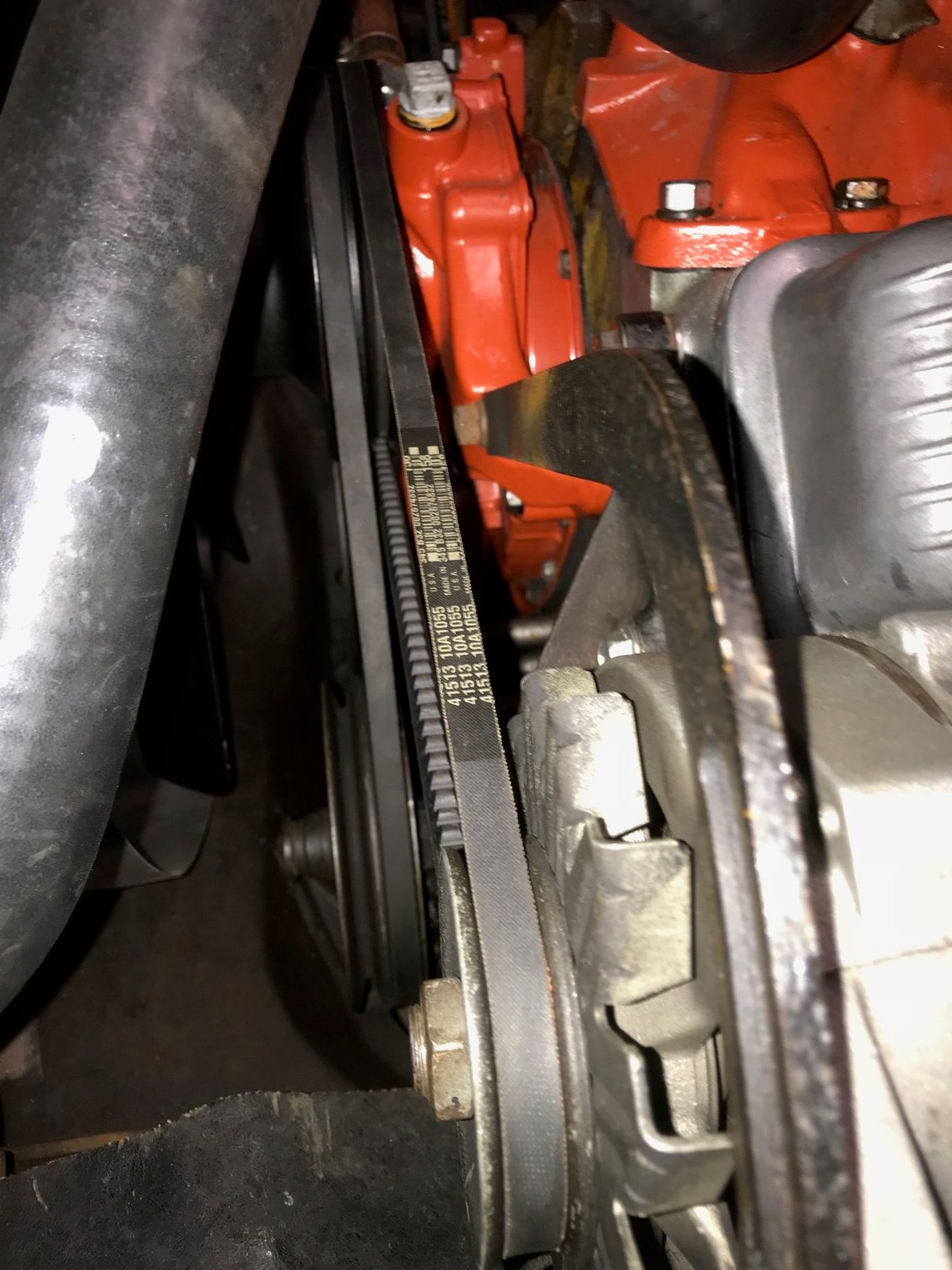

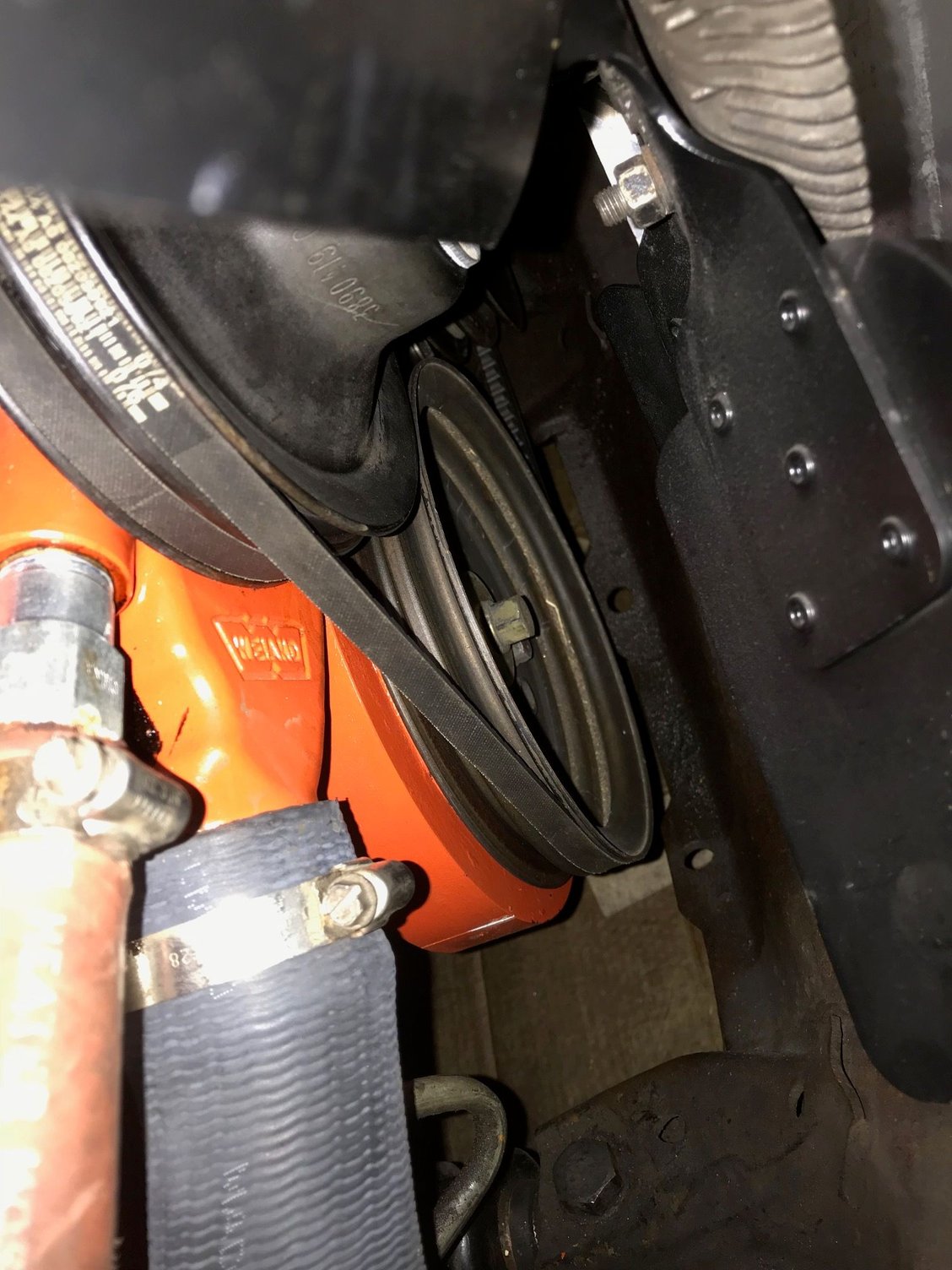

here is some info I gathered for mating pulleys together, see post # 36:
https://www.corvetteforum.com/forums...post1595410814
I've a done a bit of research on these annoying pulleys. If you provide the pulley number for the water pump pulley and the crank pulley I can try to look for the add-on pulley for you.
BUT just so you know my power steering pulley is driven by 2nd groove of the crank pulley. Picture here:
https://www.corvetteforum.com/forums...post1595072187

As you can see the P/S pulley is of a smaller diameter. T

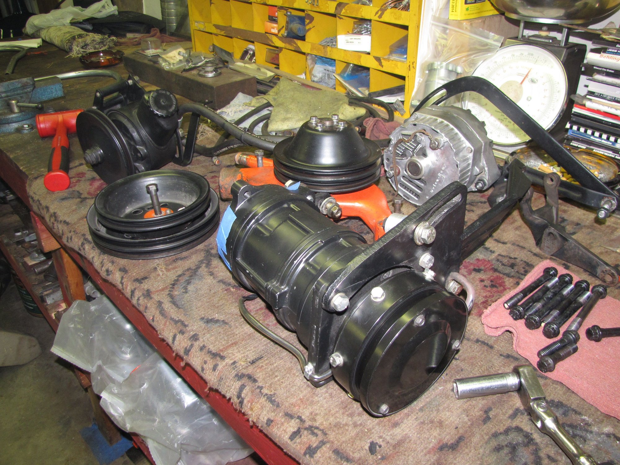

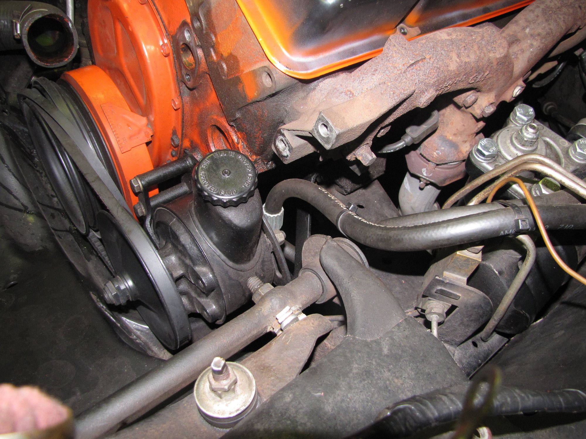

Here is my Borgeson PS pulley setup. I did not buy a PS pump from Borgeson, I had one laying around from another project (a parts trade). I recall it was for a mid 70's K5 Blazer. I did however buy the Borgeson PS bracket.
Factory two groove water pump pulley and the PS pump came with a two groove as well. Water pump inner groove is used only for the alternator. Water pump outer groove aligns with the PS inner groove. I recollect I had to put a 1mm (1/16") spacer under the water pump pulley to get a perfect belt alignment (I suspect because the aftermarket aluminum water pump was not the exact same length as factory).
The crank pulley is just the factory 69 double groove . The outer groove drives the water pump/PS pump
