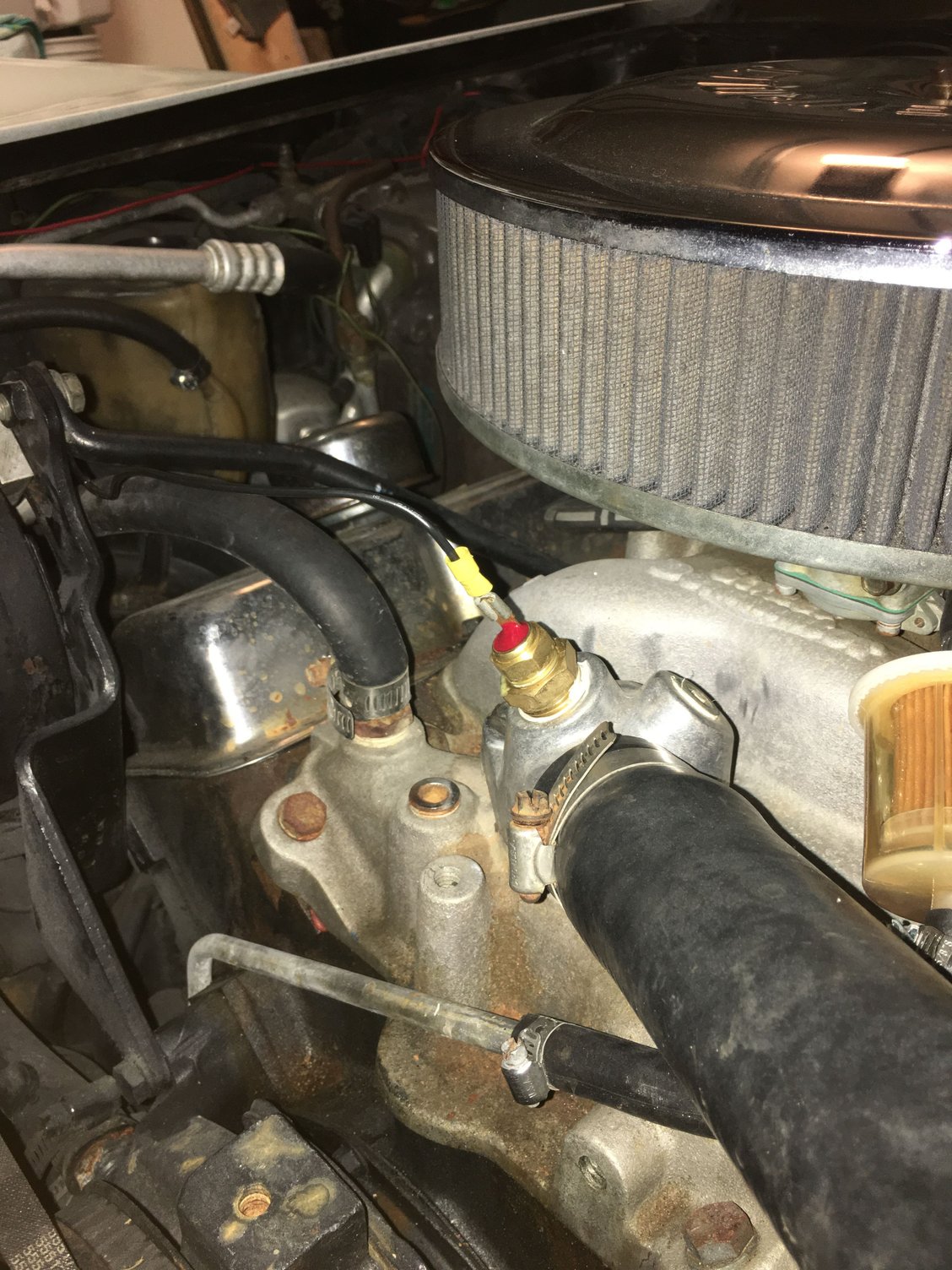

The idle test is promising. Your plan for today should give you some more data, and any excuse to drive your car is a good one. The stock location for the temperature sensor is right on the head as you describe. It should be reading head temperature near/in the coolant passageway at the tip of the sender. I'd suspect your gauge first. You can shoot the IR thermometer close to the head in this location to confirm.
If the rest of your engine compartment is stock 1979 L48, you should have up to three vacuum switches near the front of the engine, two in the water neck and one right next to it, that could be replaced with a temperature sender, though with a Holley Intake you may have already removed one or all of these. Can you post some pictures?

here’s two pics, i think those vacuum switches have been long removed. The sensor coming out of the gooseneck is for the fan relay.
