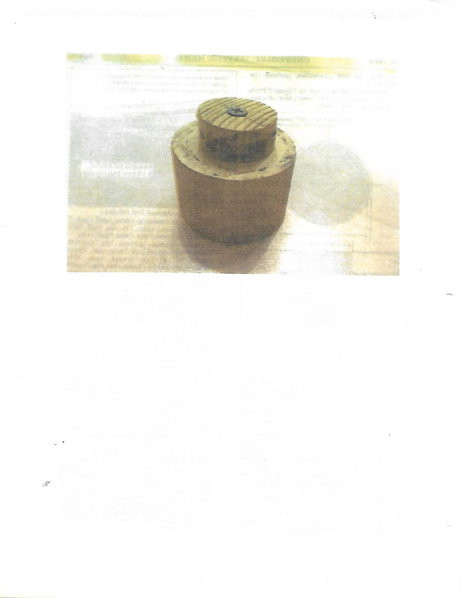

https://willcoxcorvette.com/catalogs...alignment+tool
You can buy this tool from Willcox or make your own.
