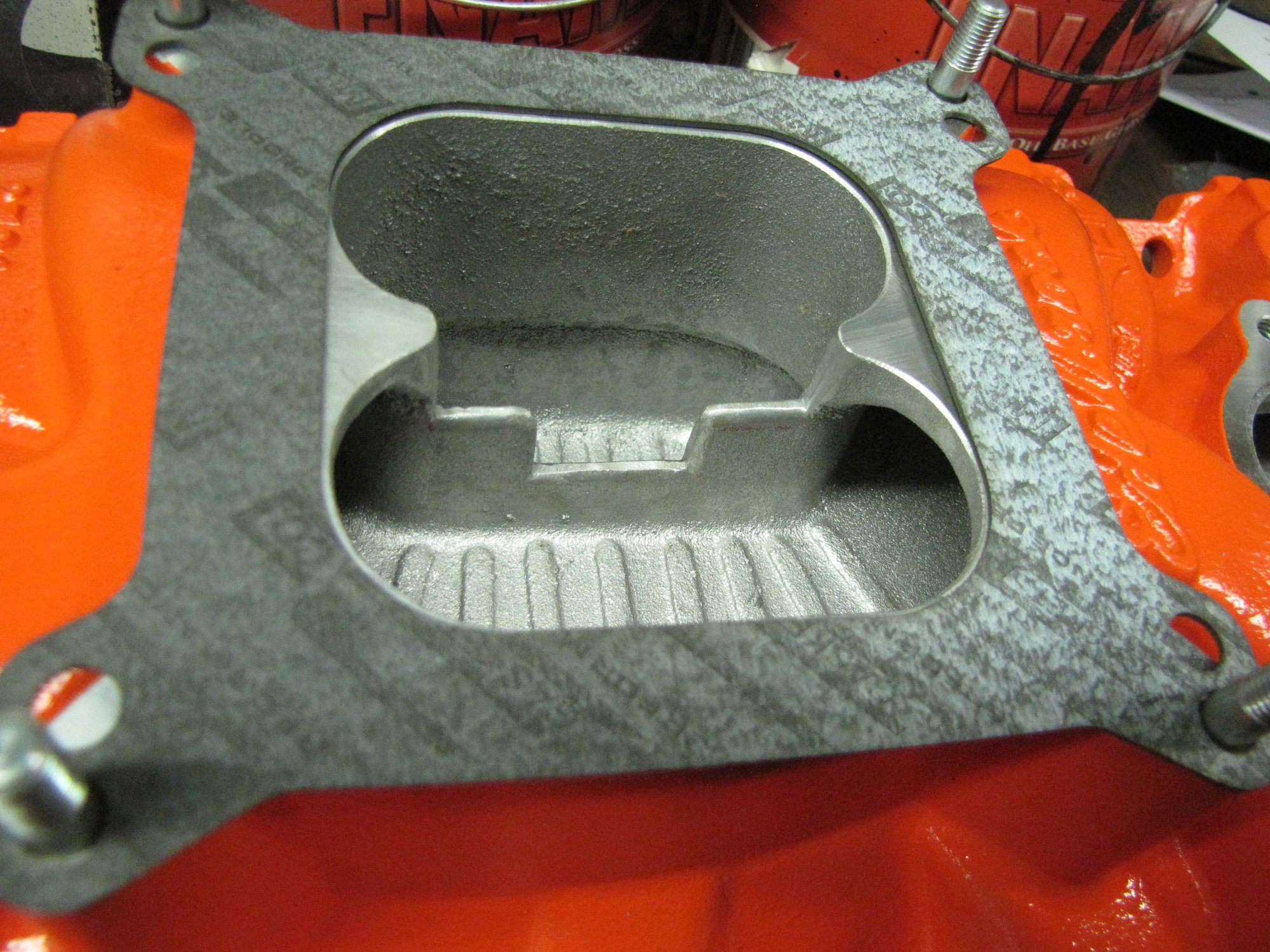

Well air gap intake has that small plenum divider cut so shouldn't be an issue!

Was running a 2101 and a spreadbore before switching to the Sniper EFI, but wanted a square bore manifold. Went with the EPS manifold then read articles about dual versus single plane with EFI, so the new manifold was modified. Been running excellent all summer. T

Are you sure about that??* There were some very long C3 intake height and hood height threads and the consensus*was that the Performer RPM and Performer Air Gap (non RPM) would both clear the later C3 hoods, but the combination of RPM+Air Gap's increased height made hood clearance a real problem in a C3 stock hood.* -If there IS a height issue with RPM+AIR Gap get the Air Gap and just cut down the divider.* The colder air is what you want and cold start won't be an issue with EFI.
I like Terry's solution. Intake wave tuning is intake wave tuning; there's no getting around it; the longer runners with a dual plane intake is going to prop up the low and mid-RPM torque curve; why lose it? The air / fuel distribution issues of a dual plane are there with a carburetor*why is it so much of a bigger deal all of a sudden when it's a computer dumping the fuel into the venturi's rather than a dumb carb??!?

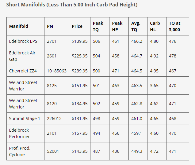

Interesting comparison of the intakes from Hot Rod website from 5 years ago
It’s a real shame they didn’t show torque @1,500 rpm - 2,000 rpm. *Stock C3 TC stall speeds were 1,650 for L48; 1,800 for L82.

Here is the link to the full article:
https://www.hotrod.com/articles/dual...d-comparisons/
I can't find part 1 though!
