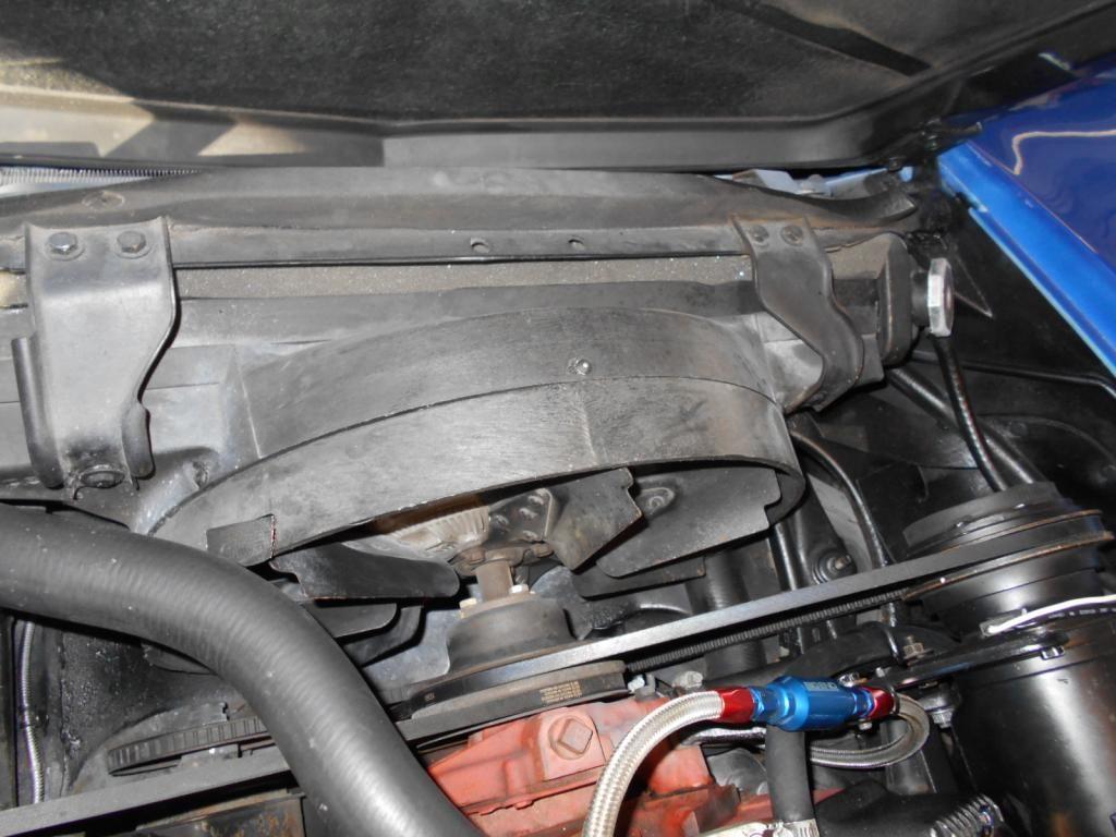

On my 75, auto we just cut the bottom of the shroud, in the middle.
You will be able to bend the sides in to reinstall it, very simple. Looks stock from the top.

Mod 75, that was what I was thinking. My shroud isn't brittle (yet), so it has a lot of flex.
As to bubba method, this car may go to some drive in shows, but certainly not any sort of concourse or judged show - it's nothing special and it is a non-numbers motor. As long as it remains as "stock looking" as possible, most folks would just see a nice looking car.
Tilting the support forward provides some relief, but when you have A/C connected, things get a bit more complex. Cutting the shroud at the bottom to give it some relief so it can go in easier without having to remove most of the support bolts makes the whole process much much easier for the non purist.
Thanks for the photos!
