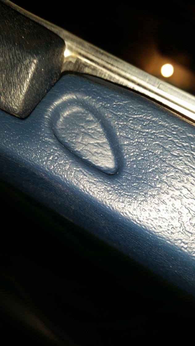

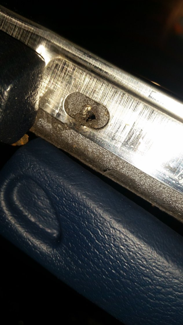

Sure.
The Hole.
The Trim.
If someone believes I can drill a hole in the trim perfectly aligned with the hole in the frame, they are over estimating my ability.
I guess I'll drill a hole in the trim where it should be, and then hope it fits the way it should fit when the screw's attached.
Steve
