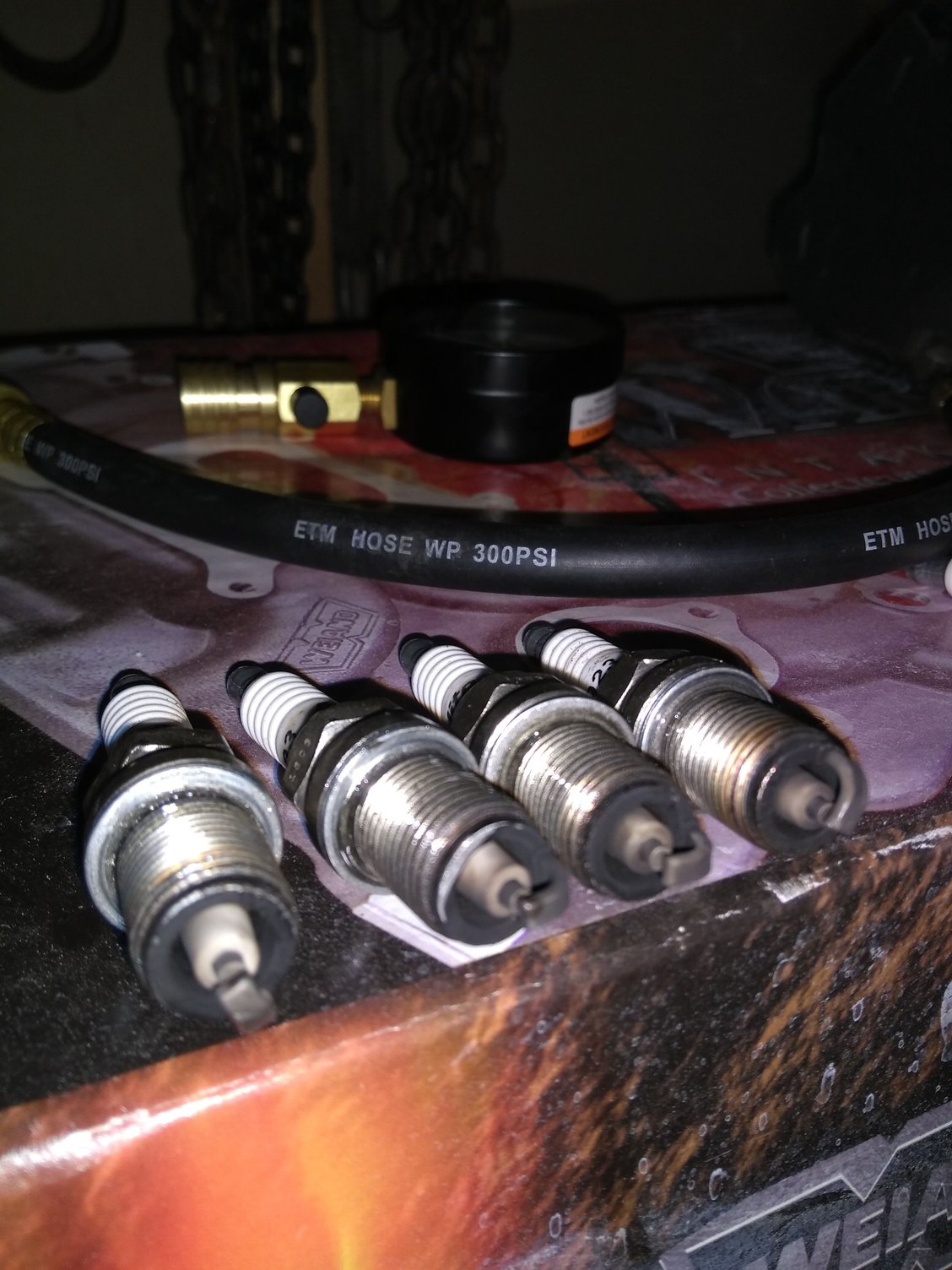

Had some time this afternoon. Did a cold compression test. ALL cylinders were 150lb. Used my timing light and checked each plug wire for spark. All had the same consistent pattern. All the plugs looked the same. Pic attached. This is after the engine had been idling for a good 10 minutes. Already had put 4 back in before i thought to take a pic.

Over all: Not bad. No apparent oil residue except maybe far right. Far left looks the best. Others almost appear carbon rich but that maybe the results of prolonged idling.
Compression is good.
Getting back to post # 1, slight miss. The thing about Chevys is the firing order and plugwire arrangement. The 5 - 7 firing being close together on the distributor cap usually results in the two plug wires contacting each other enroute to their perspective cylinders. Make sure those two wires don't touch.
