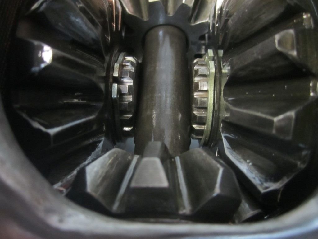

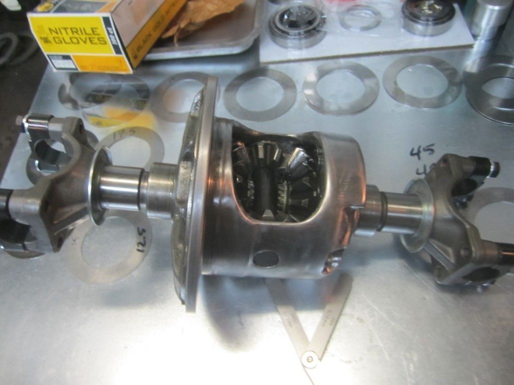

Well normal if the c-clip is missing from the yoke... which it shouldn't be, here's the clips and how they hold the yokes in
Best case, clip wasn't installed at some point
medium yoke wore and clip fell off laying in the rear somewhere
worse clip / end of yoke are in there doing damage but not enough to lock the rear up (yet)

When you removed the axle did the end look like Mooser shows in his picture with the chamfered end?
Not a good idea sliding the axle in and out as it will wreck old seals. If the snap ring is in there it would either get chewed up in the gears or get thrown forward in the gear oil.

I believe they looked like the ones in Mooser's picture. Does have the groove for a clip.

Pulled the yoke one more time and the end is flat. There is no chamfer.

If the chamfer is gone the axle is junk. You need to really follow your plan and check the diff completely.
