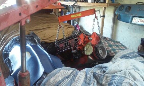

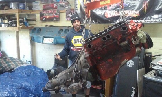

I just pulled mine w/auto trans.Pulled RF tire and positioned puller RF front corner. Had helper help guide it up and out over fender. Once your locked and loaded it takes about 5 min

That is correct. This allows the engine hoist to slip under the car. Also get an engine leveler to attach to the hoist to allow tilting of the engine as you proceed. I normally leave the transmission in the car along with the bell housing but there are more than one way to do this.

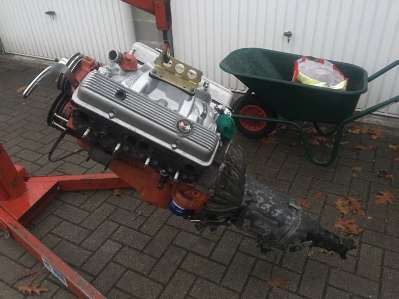

All great tips. I pulled my engine and 4 speed together as one unit. Just pulled the shift lever, speedo cable and disconnected the driveshaft. The engine leveler was great ! I removed the hand crank from mine and used a cordless impact driver to move it up and down. Definitely get help to guide it out of the engine bay.

Yep. All points are made. I did not leave my yoke in and it didn't leak.
I pulled my 454 with the trans attached. Definitely from the side and definitely need a leveler.
